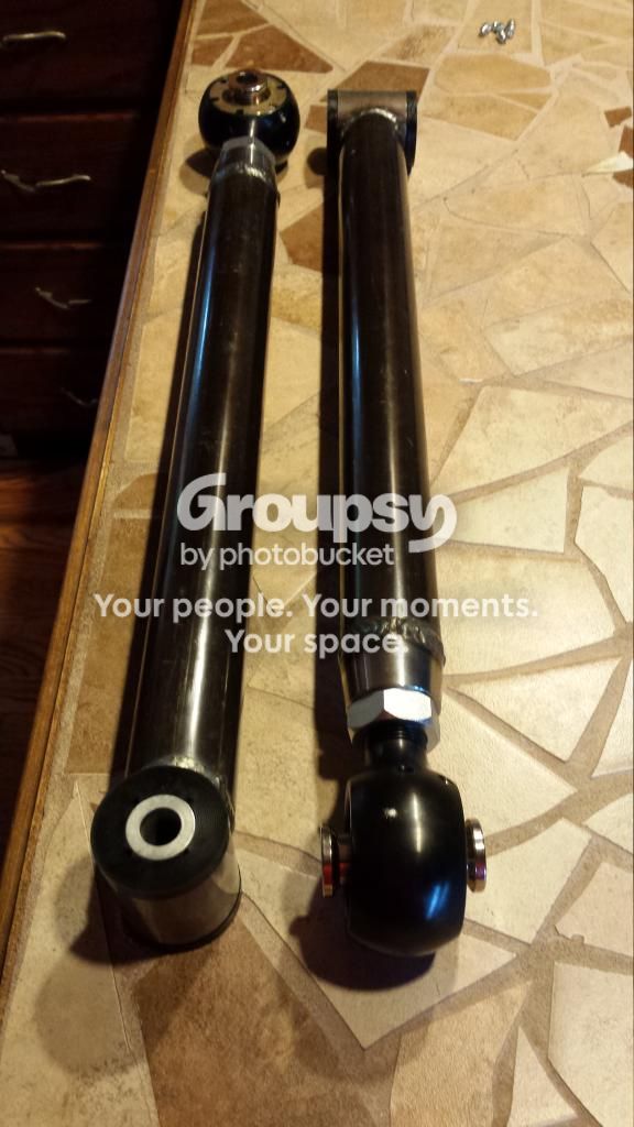

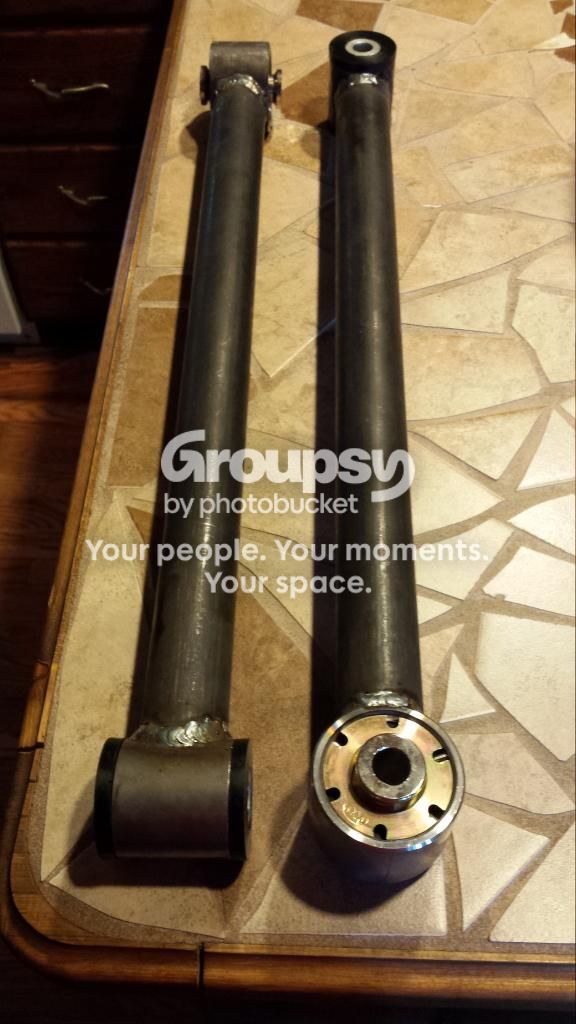

Couple sets done for some 3rd Gen guys.
Standard LCA's
20140920_173314_zpsik0yrzh9.jpg~original
Adjustable LCA's

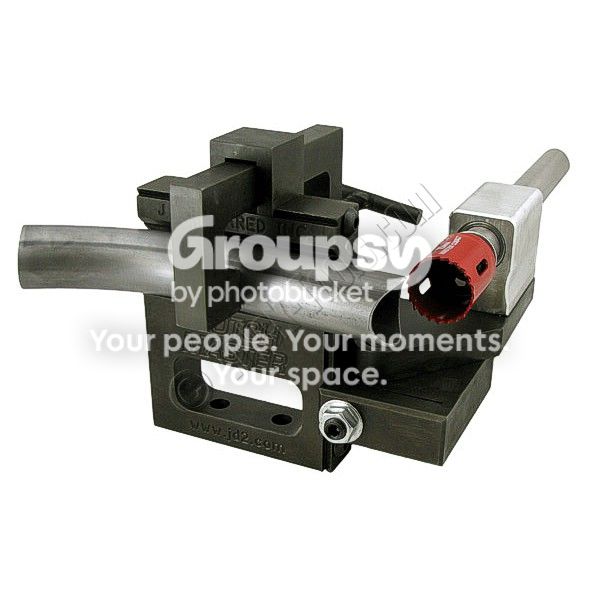

Milling some mock up bushings
