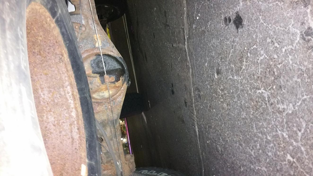

You might want to post a picture to see what the damage is. I've seen some really bad diffs.
Here you go.... Photo quality is poor.. but you get the idea. I'll shoot a better one in better light. Not sure how it came out sideways...

Looks like it might just be leaking from the fill up plug. It does have a gasket behind it and you might get away with just replacing that gasket when you top it off.
You can spray it with brake cleaner to clean off the old oil and see if it still leaks.
Yeah you're leaking through the "cover". You housing doesn't look too rusty though and your leak doesn't look like it's a bad one.
Mine was a crappy job, thought I only had a pinhole leak and 1 leak turned in to 3 or 4. Of course each time I thought I had it fixed i'd find another area of seepage (I think that's a word) and i'd have to drain the fluid and reclean the area again. Someone else might have a better fix than the JB weld putty but it worked good for me in patching it up...bought some time before replacing the housing assembly anyways. Hope you're able to break that plug loose without any drama, maybe add some heat to it before even trying.
Very true, rust may have ruined your gasket mating surface and caused it to leak. I actually had a slow drip on mine, yours doesn't look that bad.

Since it's the rear diff you can use a socket on it. A breaker bar will help. You can get a propane torch to heat the fill plug first, then use a socket. Proceed to the drain plug after the fill plug. Have new gaskets on hand before you do anything (and gear oil).
If there are holes, maybe it can be spot welded?
