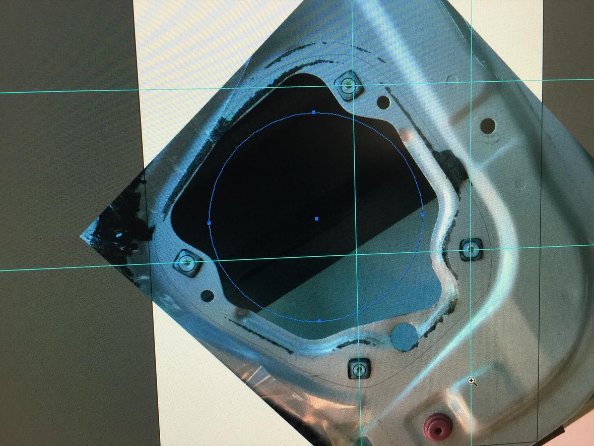

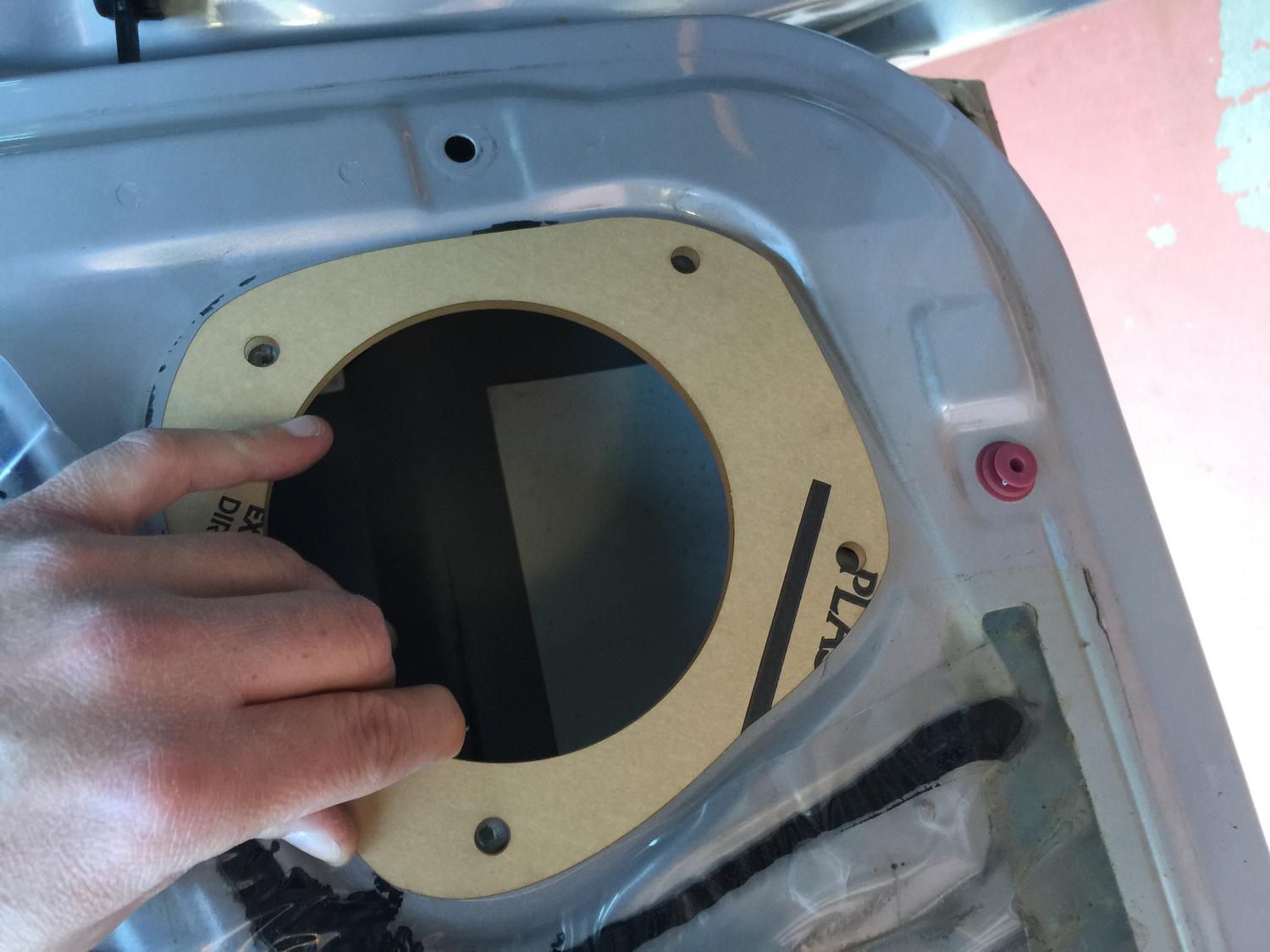

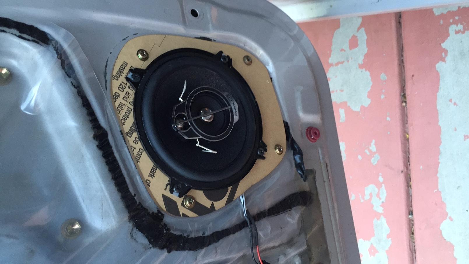

Did a speaker upgrade and needed a quick fix to fit the speakers. Made some 5 1/4 speaker brackets on my CNC laser. Can make more if anyone is interested. Made out of 3/16ths acrylic.

Thanks! Just bought my first Runner last week. This was one of many upgrades. I have plenty of ideas to use the laser again. Let me know if you ever need something and I will see what I can come up with.
