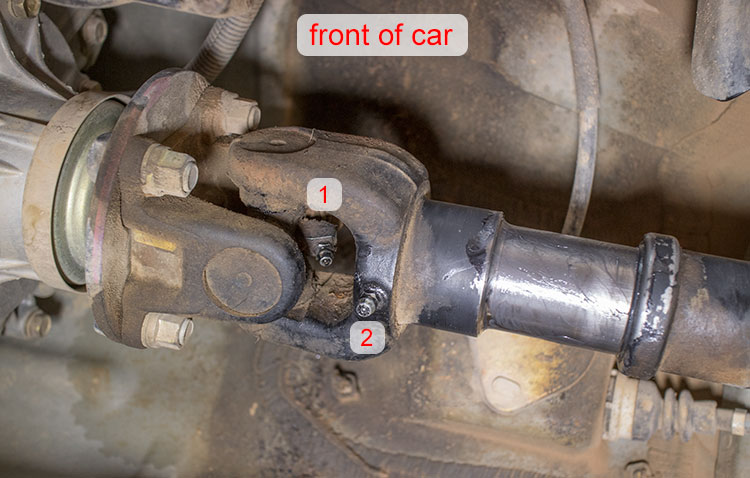

When you say slip yoke, which fitting at the front of the driveshaft are you referring to? I was doing it based off another thread and one member said not to overfill the number 2 fitting in my attached picture because it can pop the dust seal. Since you said you did the fittings at the front and back, I think you mean you pumped 20 pumps into fitting number 1 in the picture since the rear fitting is the same (a u-joint cardan). I just want to be sure before I go blow out some seals by mistake this weekend.
This is the thread I was using in case anyone hasn't seen it:
http://www.toyota-4runner.org/maintenance-detailing/220638-greasing-driveshaft-4th-gen.html

One thing to keep in mind when you pump 15 pumps of grease into a DS slip yoke spline area. Too much grease will prevent the rear DS from moving in and out as necessary. Remember the DS moves up/down and and the slip yoke moves in/out with the rear axle housing when you go over bumps or come to a stop.
So, when you fill this chamber with full of grease, you *maybe* creating a hydrolock condition. In another words, the DS can no longer compress and it's extended out by the force of too much grease. Sometimes this will put undue forces on the Transfer case rear output flange and possibly the bearing behind the flange. You've effectively removed the "slip yoke" feature of the rear DS and turned it into a solid shaft DS.
A good thing to do is to remove the zerk fitting from the DS yoke and drive it around for a few days. This will push the extra grease out and of course fling it in a circle under your vehicle, as your rear suspension moves up/down. By doing this trick, the hydrolocking doesn't occur and the DS can collapse/extend as it needs to. Then put the zerk fitting back on.
