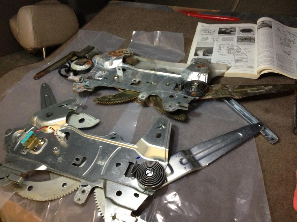

I replaced the whole motor/x-arm assembly because it seized from rust and don't think you can remove the glass without removing all the whole assembly first.
License plate holder and all.
There's on utrack on each side of the glass but to unbolt them you need to lower the window down.
You can see it on the new right side arm.

Ok, since I really didn't get the help I was looking for I just tore into it myself.
I tried the 12v motor jump which moved the glass down a bit, but not enough. Apparently the glass was hitting the wiper motor.
so I too all 4 bolt of the gear swing assembly and then the 8 bolts holding the left and right track. That enables you to slide the glass down far enough to get the 6 bolts holding the glass to the track assembly.
Then remove the window seal. the glass has to be crooked at an angle to slide it up and out. Get a second set of hands to help.
