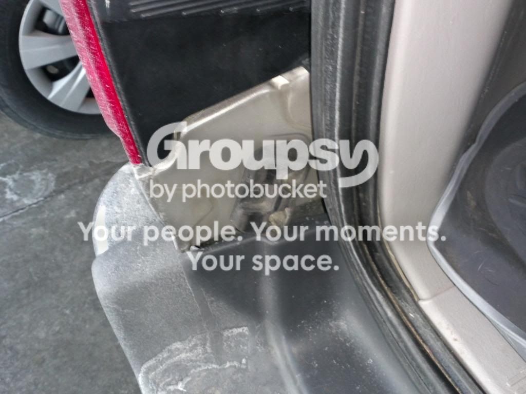

On my rear hatch I picked up 4 rubber fender washers and put them behind the plastic/rubber brackets on the frame that catch the hatch. I can get a picture later if my cryptic description didn't help:wink2:
Here is the part I'm talking about, there are 2 bolts per side. Just go to a hardware store and pick up 4(2 per side) rubber washers that fit the bolt and put them between the body and the black piece in the picture. What it does is space out the black piece to make better contact with the mating piece on the door, it worked perfectly for me but...YMMV

So glad you posted this - It totally took care of the problem. Thanks!
I did the same thing that [MENTION=82292]Crashnrondo[/MENTION] recommended and it worked for me as well. Exactly as was said, those rubber mounts must get worn after time and need propping up with some spacers to get the original contact pressure back to hold the gate firmly. Also the license plate frame was banging around so I put a few of those little round self-adhesive furniture pads behind the plate plate to keep it from touching the gate.
