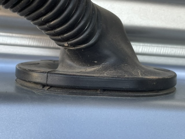

I don’t think you have that boot installed properly against the metal. I ran some wires through the boot a few years ago and remember having to massage it to fit back over a plastic sleeve that fit into a notch in the rubber boot. Hard to explain but it’s kind of a press fit. Here’s what mine looks like.

Mine is leaking too on the bottom like yours due to the retaining clip crumbling to pieces allowing the boot to just float outside of the seal.
