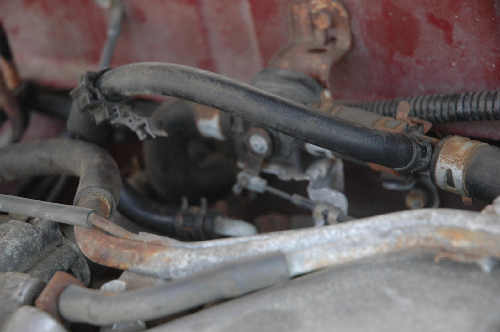

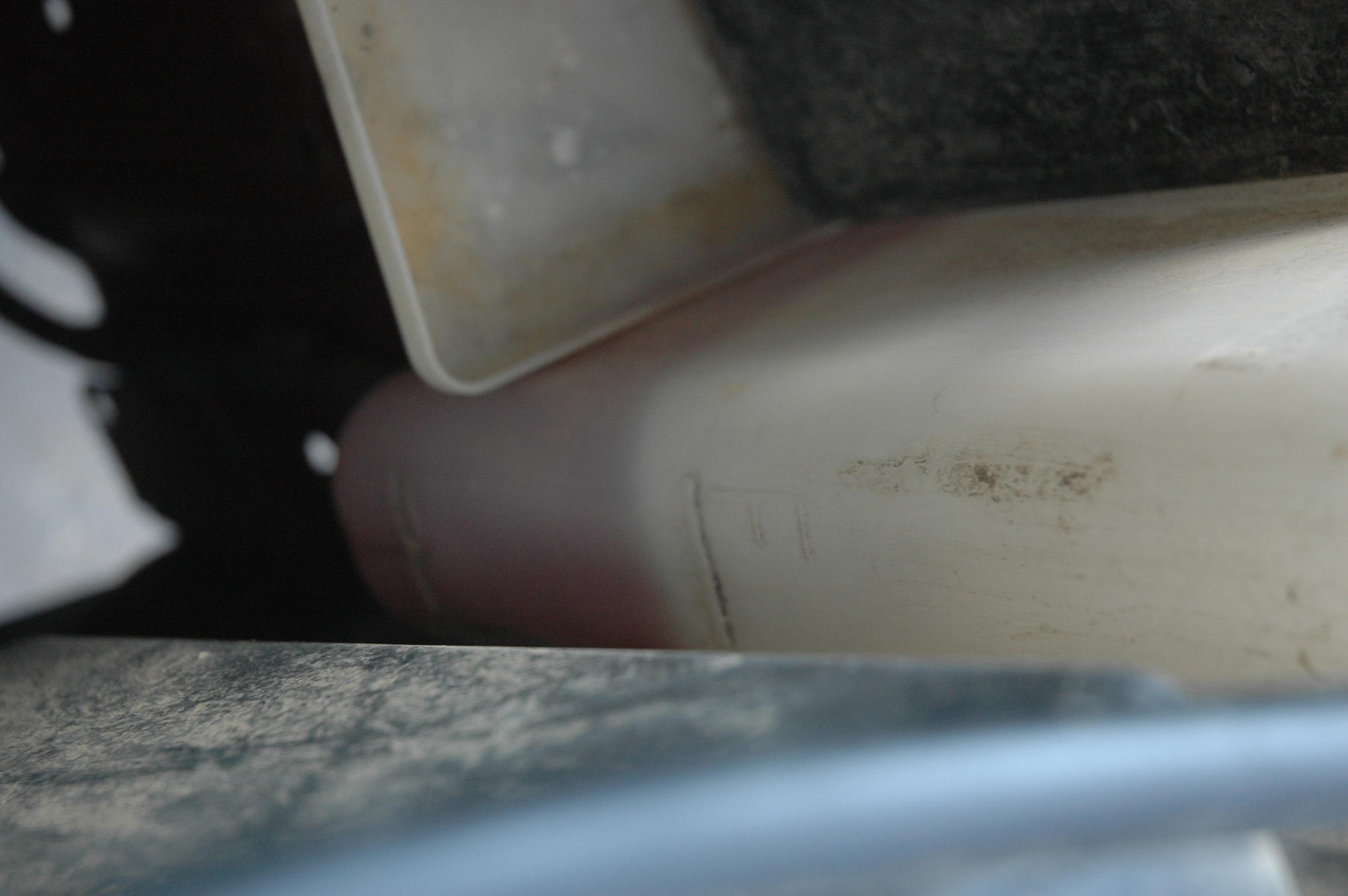

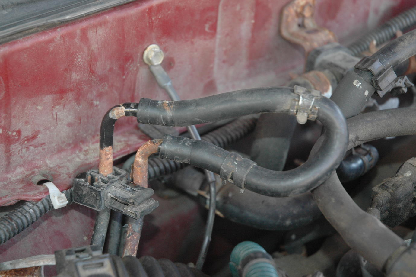

Please do this at your own risk, this worked for me, your results could vary, i am not responisble if anything happens to your vehicle as a result of this mod Here is the Fix to loop the coolant before it gets to the rear heater lines, I just disconnect one of the rubber hoses from the rear heater lines, and disconnected the other rubber hose from the coolant distributer thing and then put the rubber hose that was disconnected from the rear heater lines and put it on the open slot on the coolant distributer thing. The pics are way more helpful than this paragraph. I just put the spare hose on the coolant lines so when i eventually fix it i know where the hose is. Make sure you connect the hoses back on with the metal clamps or else it may leak. And thegreenmonster gave me this idea. The first pic is the rear heater lines with the spare hose, 2nd pic is the hose that looped the coolant back through the system disregarding the rear heater lines, the 3rd pic is how nice it is to see that thing filled up with fluid.

I had the same problem. Rusted out and leaking rear heater lines. Bypassed the rear heat under the hood like JohnsD90 did on his Yota. Took about 10 minutes and worked like a charm. I don't have rear heat in any of my other vehicles and it's just fine. More of a luxury item anyway.
If I ever want to throw $80 at my 4Runner and replace those lines, I can just undo the bypass and I'm good to go!
