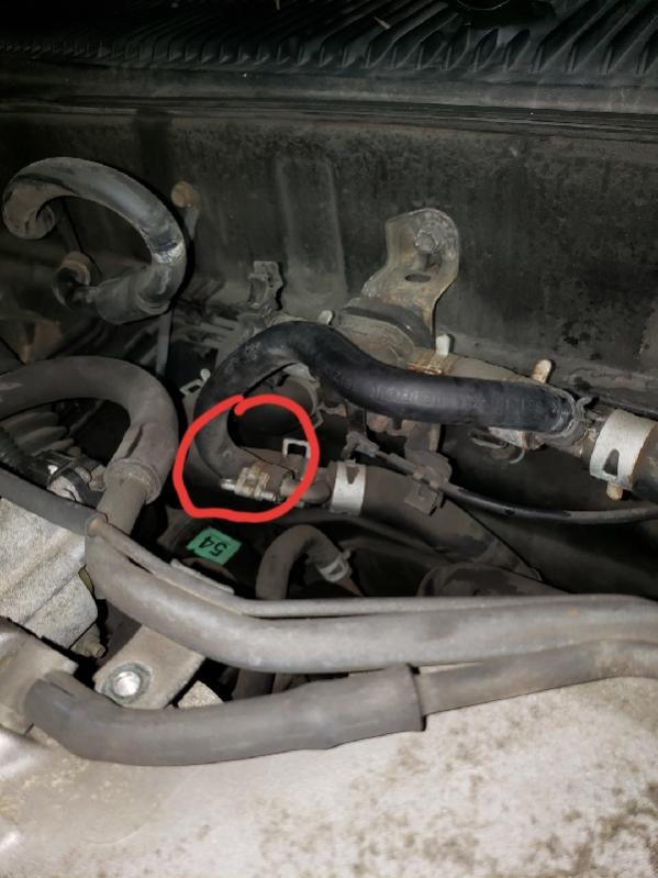

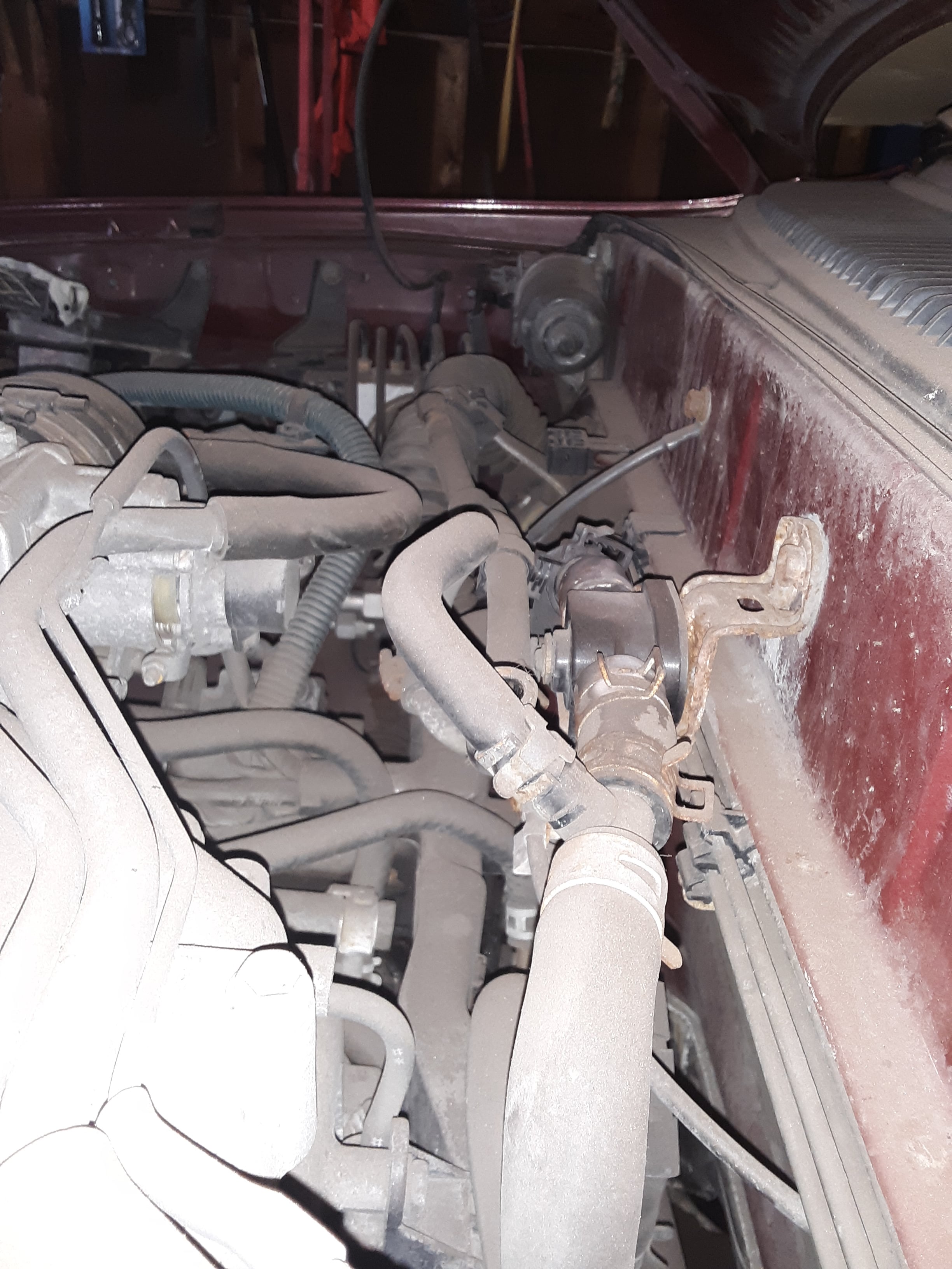

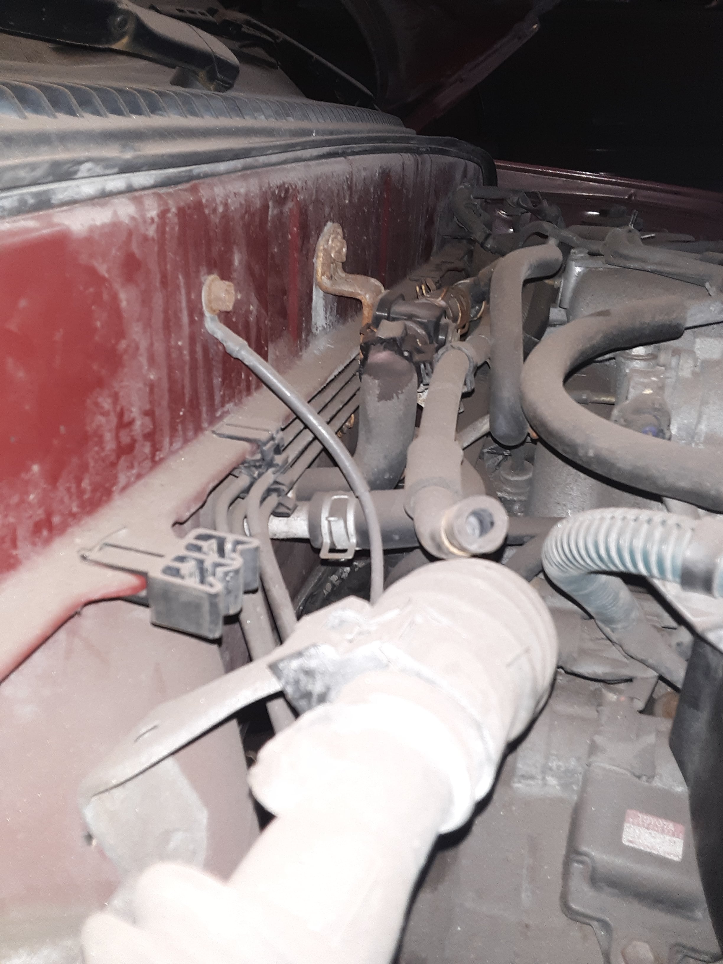

Like this. You take the one line and loop back and hook it to the other. Like the pictures show. If you need more photos let me know.

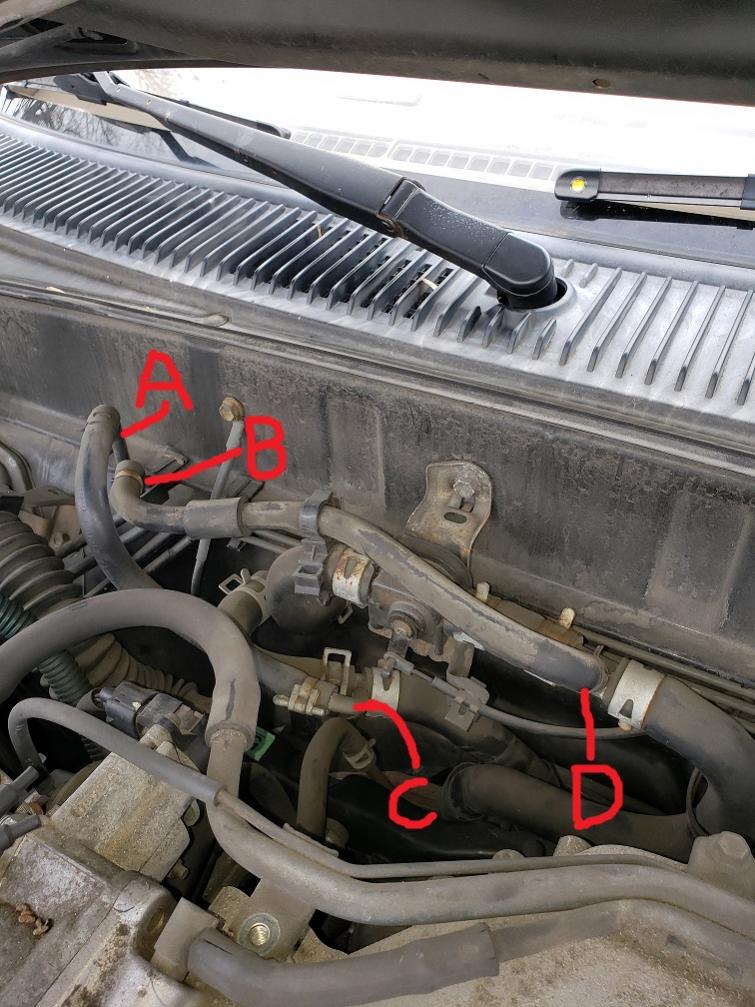

I'm going to do this bypass soon, these lines are about toast on my '97. I want to make absolute sure I'm doing the bypass correctly, could somebody check me on my attached picture? The process is loop A to B, then loop C to D, correct? I might just cut the lines under the rear heater where they exit the floor board and "loop A to B" there...

Take the other side of C to put it on D. Done. Look at my picture. You can see that what I did and it's just long enough.

Thanks! I guess looping A to B like I've seen in other pics is just a way of keeping crap from getting into open/unused lines.
