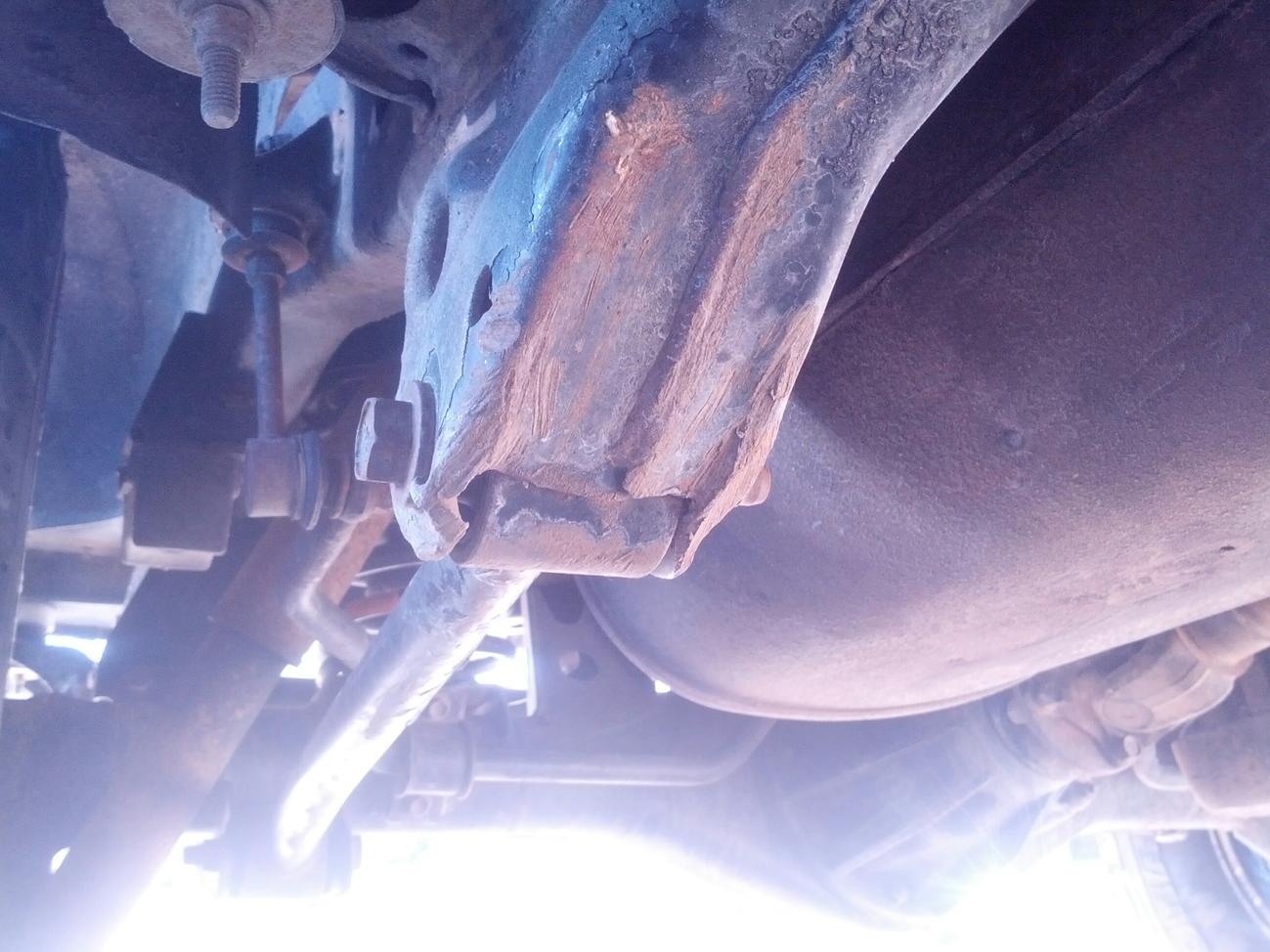

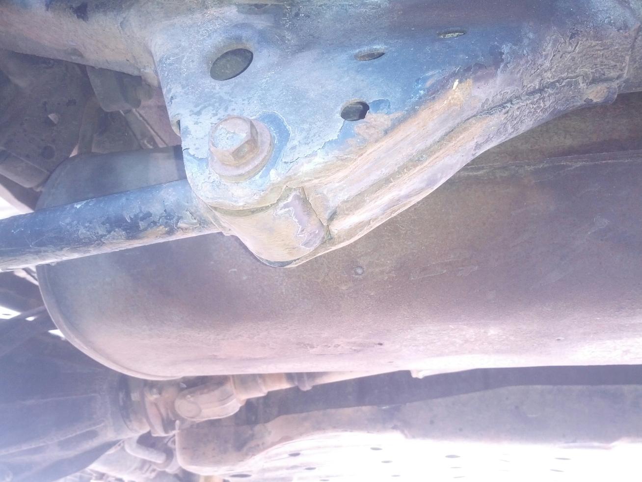

I'm trying to figure out what I need to do about my rear lower LCA mounts. They have pretty much been torn to hell at this point.
What are my best options as far as replacing the whole mount with something with a little more beef? I don't know of any aftermarket so I'm guessing this would be a custom job.
I could also try to repair my current mounts and plate them, but I'm not sure if they are beyond the repair stage.
Anyways, here is what I'm working with. What does T4R think?

I would just buy Lotus RCAMS and put them over the existing mount. I wouldn't mess with trying to cut that one off and recreating it, i would hate for you to mess up your link geometry.

Yeah I had seen the lotus skids, but as I've been adding parts they have just gotten pushed back on the list. I didn't think those mounts would be as much of rock magnets as they are. too late now.
I reckon the easiest way to go about it is straighten out what I can and throw the lotus mounts over top as NateMob suggested.

As far as the lower control arm mounts, I'm with NateMob. Just straighten them out as best you can and put some skids on there. They don't look too bad to me.

To the OP, I'd say its repairable. You can weld a nice plate on the front side of it.
You may want to trim the parts rubbing on the control arms before installing the skids. The mounts do look beat up but, from the pictures, the mounts don't look tweaked out form original position.
Worst case, mount the skids and weld them on.
