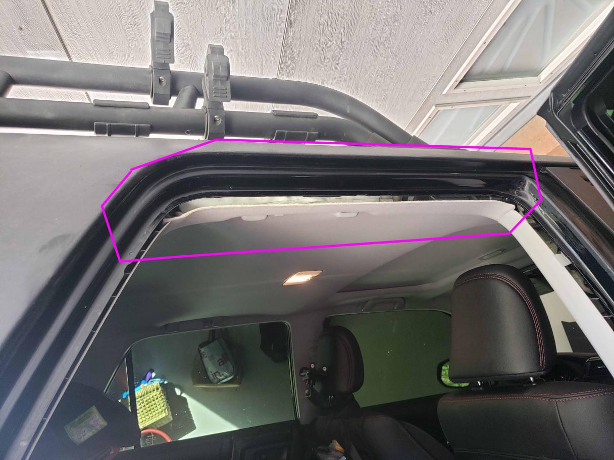

I usually don't mind some rattles but this creaking or ticking noise has been driving me insane.
4runner Interior Creaking / Tick / Rattle Noise. - YouTube
It happens soon as it's in motion, the video is reversing out of the garage. It's the creaking sound. It definitely sounds like it's coming from the rear passenger top roof liner area (curtain airbag).
Wondering if anyone came across a similar noise and was able to find the source.
It's definitely not: cargo mat, suspension, exterior, seat latch, frame, seatbelt, door, hinge, weatherstrip, or it needs grease, I did my thorough research before posting.
TIA.
To help dx the location of the noise, have partner/buddy drive while you are in backseat firmly pressing/holding various areas to see if you can make squeaking stop.
I did actually try this and even drove with weather stripping rubber partially off.
The squeak was still present even if I pressed the headliner, curtain airbag and etc, whatever I can reach with my hand, the spaces were tight.
It's the most present when a vehicle's weight is shifting (like moving in incline or coming to a brake or accelerating). The slower the speed, the more clear the squeak.

Little Update:
I am guessing it ''could" be a common thing, after a week of messing around and I checked whatever I can to without pull off headliner or taking things apart (don't think it's moonroof).
So I ended up getting bunch of sound soundproofing foam from Amazon and just shoved it into inner spaces after taking off the rear door weather strip. Even into spaces around curtain airbag, in case of accident, I don't think the foams will interfere with deployment.
This definitely defused the sound, whether it was traveling from somewhere or directly, the tick noise is still there faintly, but not enough to bother me anymore.
My overall guess is it's from attached points of curtain airbags. There are number of them attached to the metal body. Something is rubbing and flexing during the vibration of driving.
