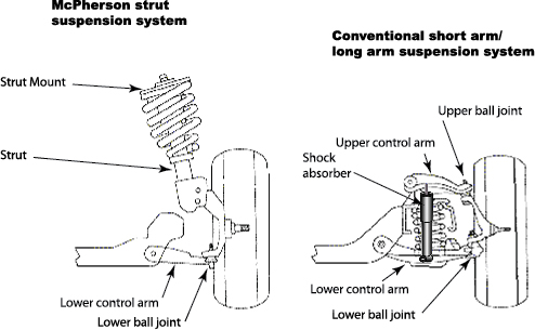

yeah the shock vs strut thing is kinda confusing & the term companies use arent really accurate for all cars, the monroe "quick strut" was originally a complete strut & spring assembly that used that term, it just carried over to other vehicles since its kinda catchy.
but the basics are that a strut is a complete integral part of the suspension & steering of the vehicle... think front wheel drive cars, the strut has a bearing plate that allows the unit to be part of the steering & fully supports the weight of the vehicle, instead of using upper & lower control arms. i will let you do your own search for better explanation & terminology of struts.
what 4runners have in front are actually considered coil over shocks.
