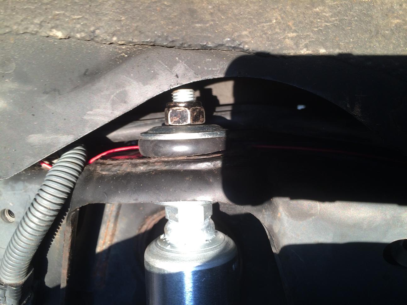

G gx470 New member Aug 29, 2016 #1 Does this look okay or is it too tight? Attachments image.jpg 128.2 KB · Views: 1,286
M Morphyne New member Aug 29, 2016 #2 Too tight. 2 rules of thumb. Rubber should not squeeze out past the metal washer. And the instructions say three threads showing.
zidaro New member Aug 29, 2016 #3 Morphyne said: Too tight. 2 rules of thumb. Rubber should not squeeze out past the metal washer. And the instructions say three threads showing. Click to expand... What he said. You want it to absorb energy and flex
having fun New member Aug 29, 2016 #4 Picture shows 3 threads. LOL. I have poly ones, and tightened mine down with some torque, and show the same as yours.
G gx470 New member Aug 29, 2016 #5 I'm confused, I don't know if I have poly ones but it is three threads but, the bushing is slightly past the washer. Should I loosen a tad then?
