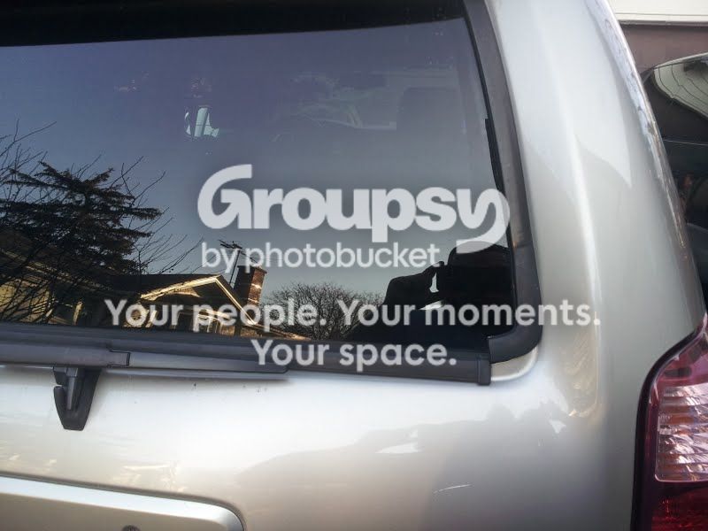

Here is a picture of the back window, you can see on the right side where it doesnt reach all the way down.
mail.jpg~original
So that part is $95, but it looks like it does not include the bottom section. Is my assumption correct?
Spendy part, but it is better then getting rust..Thanks that was the part I thought it was, just need verification. I ordered that and the bottom strip, might as well replace the entire back area..

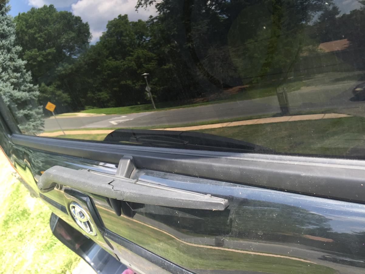

Replaced the bottom weather seal lift gate
Just replace the bottom weather seal of the lift gate window. The part was cheap, $28 and replacement only took 5 -10 minutes. My old weather strip dried and was falling apart. Every time it rain water goes in the door and leaked out the holes at the bottom of the lift gate.
During the winter the lift gate would freeze and would not open. Now that it's fix, less water would go in the door.
