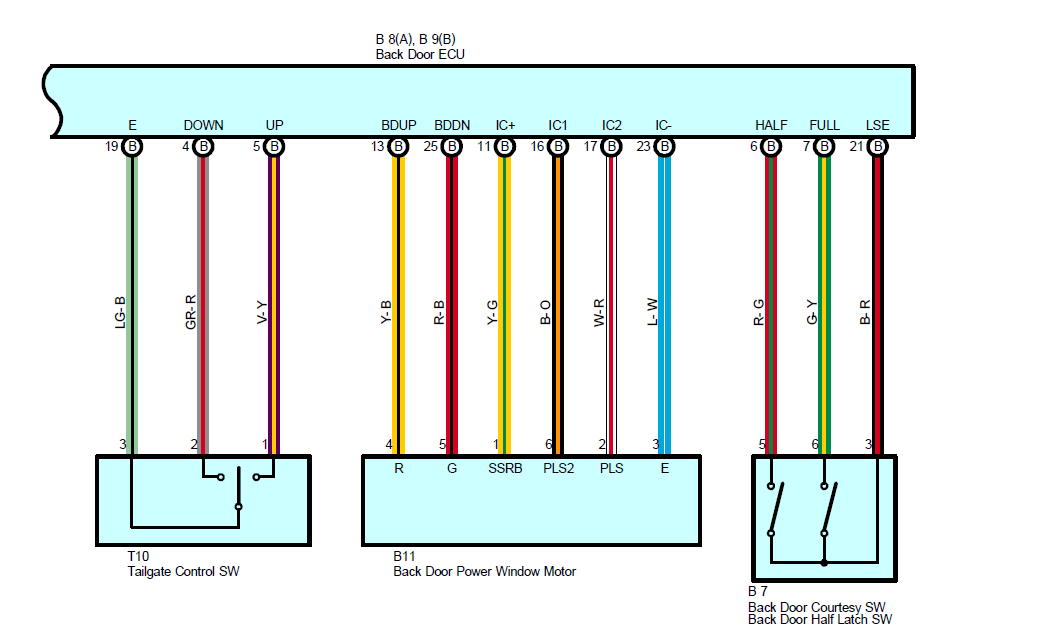

I have seen the mod to allow you to open the rear hatch with a momentary switch from the inside. I was wondering though if there is a way to install an additional switch to open and close the rear window in the cargo area? This would be nice if you could do it while the key is not in the ignition as well, for camping purposes.

Because I thought someone did do that. It shouldn't be too hard all you're doing is just tapping the existing wires for the signal input to the rear door module, you could wire your dash mounted switch to an always hot fused circuit or just wire the second switch in the back to an always hot fused circuit and have no issues.
Hey BlackWorks, yes I would like to mount the window switch somewhere in the cargo area, it doesn't have to be on the door or could be. That would be a nice little mod to do. I appreciate the feedback.
I installed one on my 3rd gen. I tapped into the up down wires on the hatch key. As with the key, push and hold the switch for a second and then the window moves. It's awesome for camping.

if wired to the hatch key switch it should be able to lock, unlock, roll up, and roll down the windows. hopefully someone figures out how to do it
The manuals are stickied on the main page. Just look up the electrical schematic for the wire colors you need... no different than wiring any other switch at that point once you know the colors.

Based on the schematics this doesn't seem to difficult to do. Also reading through this I learned that the key in the driver's door lock is suppose to roll all windows up and down. Never knew this, so will be trying it out tomorrow. See pic for the wires you need to tap at the back door. Good luck.

i did tap the tailgate key for the signal for the windows with my alarm. it just need a ground signal for it to roll up or down, also this will lock and unlock. might not be good if you have an aftermarket alarm, usually u forget if the truck is disarm.
