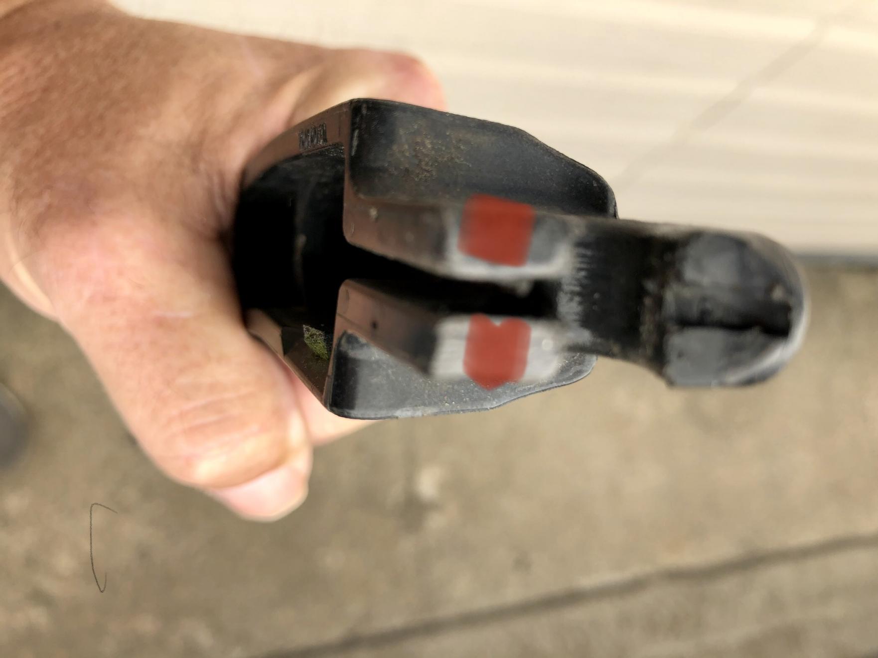

Just did this fix and it worked like a charm. No need to remove the spring. All you need is a small saw, a 10mm socket and a small screwdriver. I used the screwdriver just to finish popping the tabs off as I couldn't quite cut all the way through.
If your wiper arm comes off easily this takes very little time. Remove 1/8" to no more than 3/16" off of the stops. I took a few pictures. Click on the link below to see photos.

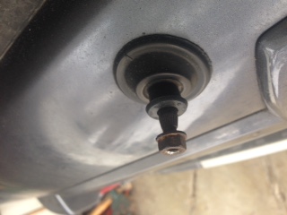

Just adding on. I had the same problem on my 2004. The wiper was barely touching the glass. It used to work fine. Replacing the rubber insert did not help.
But after taking off the cover (that covers the nut that holds the entire wiper on) I noticed that the blade arm had split on one side of the attachment point over the motor spline. So the wiper still moved back and forth, but did not have the right angle anymore.

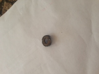

I am just adding that the metal grommet inside the plastic arm that slides on the motor spline was totally rusted on. The plastic arm just fell apart and all I was left with was the motor spline with the metal grommet fused on it. PBlaster did not loosen it and I did not want to torque it too hard with pliers.
But the earlier references to a puller helped. I ended up going to Autozone as they will lend out tools for free as long as you return them. I picked up a three arm puller. With some work, it popped off the rusted grommet. With some cleaning solution and a small wire brush I cleaned off the spline and it looks good to go while I wait for the replacement. I did put a light coat of oil on after cleaning so the spline remains rust free while I wait for the replacement. Here are some basic photos.

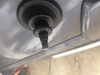

Here is the cleaned off motor spline. Note that the spline part is tapered. The threaded part is where the nut goes to hold on the wiper.
The puller may have a point on tip the bolt you tighten, but it was easier to put the wiper arm nut back on a few turns and rest puller bolt in the natural cup this creates. Note that the nut is not tightened down right to the spline. This leaves a bit of room for the wiper grommet to pop off. But make sure to tighten the bolt enough so there are a few threads for support. You just want a small space for the grommet to pop off the spline. That's all you need as the spline is tapered. Once it pops you can easily remove it by hand.
Here is the actual metal grommet that was embedded in the plastic arm. Yes, it is a bit chewed up as I gently tried using wrenches to remove it. It rests on the tapered spline in the front of the tapered spline right next to the threads. It does not go all the way back. But note how small it is. The puller worked well, but I had to rotate it a few times to get the best grip behind this grommet.

In photo 2 the wiper arm is removed from the vehicle and laying on it's side. you can see that the bottom of the wiper arm lays almost flat against the tape measure. If you remove somewhere between 1/8" and 3/16" off of the two stops shown cut in photo 3 then it allows the wiper to have a bit of an angle compared to the hinge point and the spring will now pull the wiper flush to the glass. It has been working perfectly for me since I did this simple fix. In photo 3 I just show the cut but had not removed the ~1/8" ends. They popped right off with a light pry of the screwdriver.
For most people the hardest part was removing the wiper arm. Luckily mine easily came off. I hope this helps.

I like this solution way better than the add on spring mentioned in other threads on this subject! The spring appeared to be effective, but looks hokey as hell! Not to mention the extra spring would be another thing for the car wash to snag and tear off. As it is now, I need to slide a plastic sleeve over the whole blade/arm before going in to prevent the blade from getting ripped off by the swirling cloths. I hate car washes, but it’s a necessity with all the salt they use here to keep corrosion at bay, since it’s way too cold to wash at home. Anyway, I’m going to try modifying the stops as this seems like the best/cleanest solution. Thanks!
Thank whoever it was that posted the trim a piece off the arm solution! I was in the process of trying to figure out what the problem was with my rear wiper when this thread popped up. Worked like a charm.
Just finished trimming the stop on the wiper arm. Works like a charm. Nice to have a working rear wiper. Thanks for the how-to!

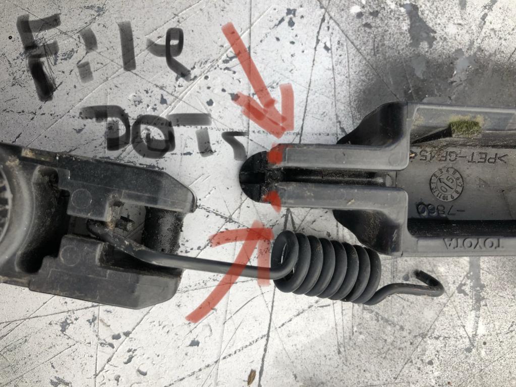

Pics
Pics of rear wiper blade - marked in red file down with small file. Works great. Disconnect spring to gain full access to area to be filed. Use needle nose pliers to remove/replace spring
This solves the problem. Let wiper run use spray bottle of water and see the difference of how the wiper blade lays on the glass
