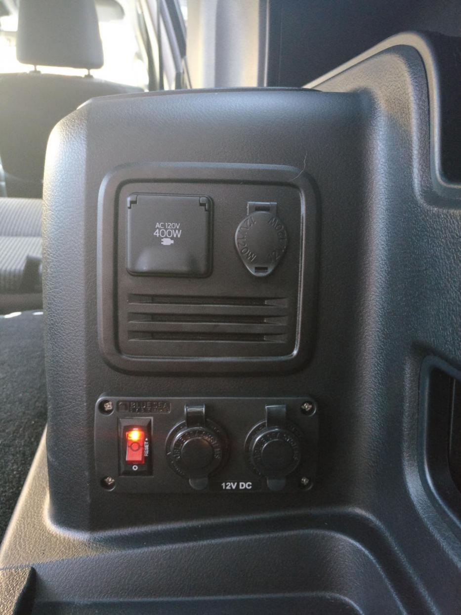

I installed a Blue sea switched 12volt outlet and usb ports on the PS fender well in the cargo area.
Rather than post it all here, Just go into my ALBUM PAGE I wrote the whole process up for others to reference .

So I got a Blue Sea panel with 12v outlet, dual USB charging ports, voltage meter, and switch to turn the panel off. I ran a 10 gauge wire from the under hood Blue Sea fuse box all the way back. All wiring at the panel is also 10ga which is tight but doable. There's also a 30a breaker before the panel.
I'll be switching the 12v for Anderson connectors soon as I don't like how the play is on the cigarette lighter style.
