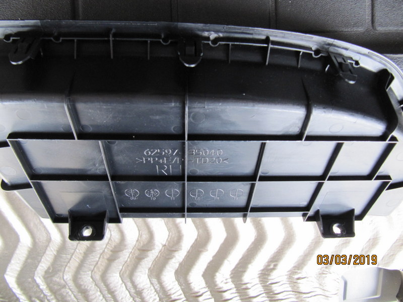

The tray on the PS can be removed without breaking the screw tabs. Use a flexible screwdriver adapter lift the tray just high enough to guide the Phillips tip flexible head to the screws once your on the screw it break loose in a couple of turns. You can see in the photos in my album I used a plastic pudy knife and pry up on the tray. The tray will go back in but I would not try to reinstall the screws because you will occasionally need to get back in. use some Velcro.

Here are some photos of how I removed the tray.
It may require a small mirror to locate the screws but they only take a couple of turns to remove them.
The photo of the tray shows the location of the taps where the screws are.
I used a fexable adapter on a 1/4" nut driver with a phillips head.
The screws are phillips head.
I was able to put my hand under the tray to guide the driver onto the head of the screws The tray will flex up enough to allow you to do this without breaking.
