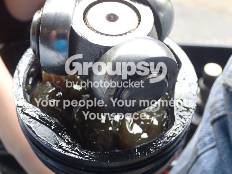

1) Today the hubby rebooted the 99's right cv shaft. It's the regular oe add version. From that experience I wanted to note that the
Toyota #04438-35060 CV reboot kit (that comes with everything to reboot one shaft)
does NOT require the use of this mentioned tool:
https://www.amazon.com/gp/product/B0002SRDDC/ref=oh_details_o01_s00_i01
The oetiker clamp tool is still needed for the outer boot but the inner boot clamps can be closed by hand and use a pliers to fold the keepers over.
2) Another note for those of you with the manual hub conversion: The c-clip is there, it's hiding under the tripod. Move the tripod to find the clip.
Pics of the MANUAL HUB cv shaft and how to get the tripod off- post 2427
habanero's 1996 4Runner Build-Up Thread - Page 122 - YotaTech Forums
Everything else is just as the write-up here describes other than the need for the Amazon clamp tool if using the Toyota cv boot kit (part number for the manual shaft 04438-04021 is different from the a.d.d. 04438-35060 part kit).
