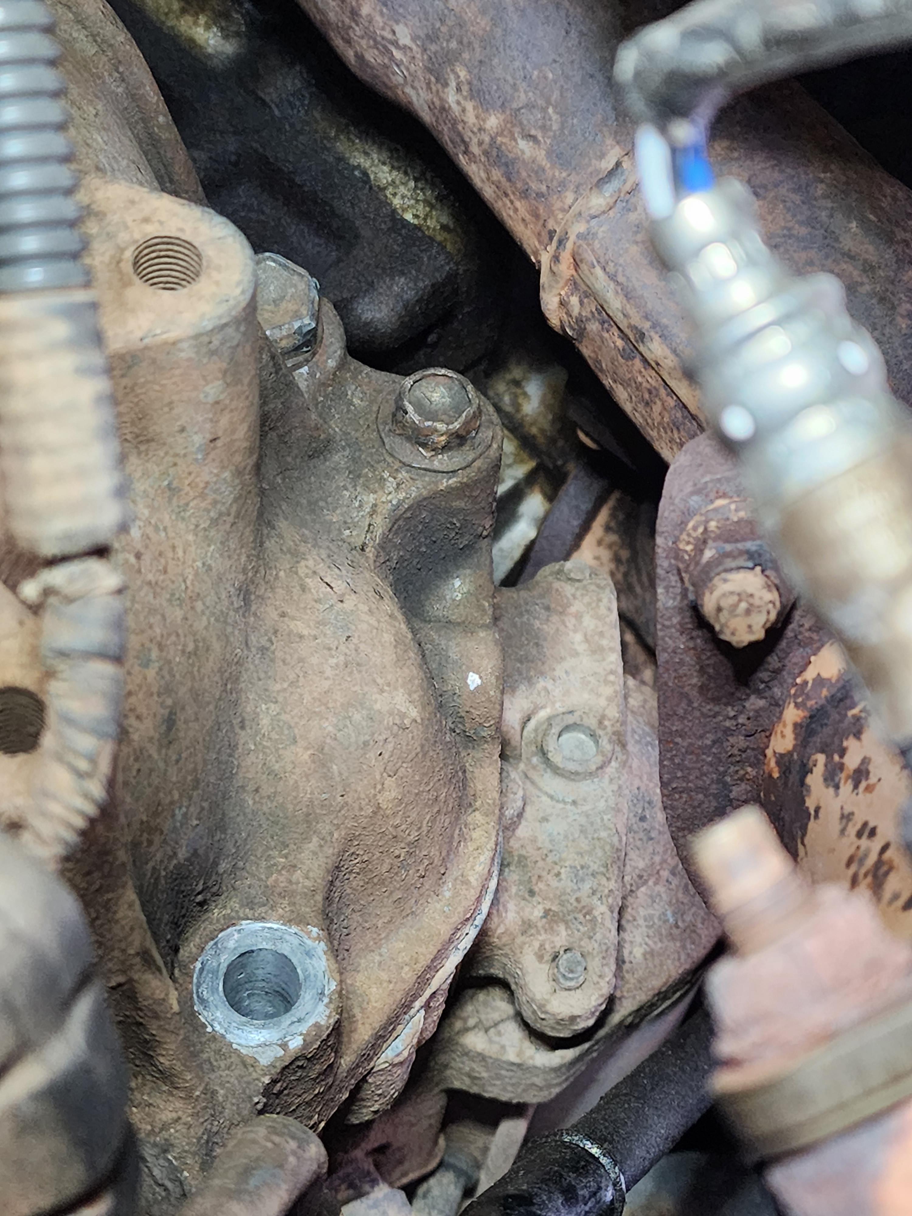

There's two long bolts holding my starter in place. The bottom bolt I am able to get out. It's the top bolt that I'm unable to remove due to location and angle. It's wet and rainy right now but I'll search for a quick picture for reference.
Edit: it doesn't appear that my starter is attached to the exhaust by a bracket either. I haven't seen one anywhere in that area.

I don't mean to hijack this thread, I got lost in my own thoughts while I was writing on here yesterday. I've watched your video a few times now Tim and I just can't seem to get it to budge. I'm not quite sure why I'm getting so hung up on the top bolt. There isn't a lot of space to work with, but I swear you make it look like cake in the video. And all the writeups that I've read explain it as a 30 minute job start to finish.

Try soaking that bolt in PB blaster, I bet it's rusted in place.
Tim and I are in CA and we don't have the rust issues much of the rest of the country have. My starter was a 30 min job, too, and I also hit those bolts from behind.
My buddy Ed swapped his starter 100% from the wheel well, ratchet and all.

Definitely have used PB blaster and even a bolt extractor. I just can't get a good angle to move a wrench around in there, even with extensions and swivel sockets. Sounds like operator error but I'd like to think not.
I'm interested to hear how your friend was able to tackle it from the wheel well. Especially with the exhaust pipe right there! Lol. If only my truck was a Cali rig, I'd just unbolt the exhaust and go full send on it.

The top bolt on my starter. Photo below.

Its right there. I don't remember having much problem with the starter through the wheel well.
Exhaust in CA is still not guaranteed - I broke a stud on the downpipe thinking it would be easy...
-Charlie
I used a bunch of 1/2” extensions that reached past/through the crossmember
And a swivel socket or a ball universal and a 1/2” impact or breaker bar for the starter bolts. Every stinking 4Runner those bolts were nasty tight
Edit: that top bolt looks mangled. Good luck getting a good bite on it with a socket unless you can hammer a slightly undersized one onto it.
How I get thst bolt is 6 point sockets with a lot of extensions out past the crossmember like the other member suggested. Once loose you mostly can take it out with a hand wrench...:)
