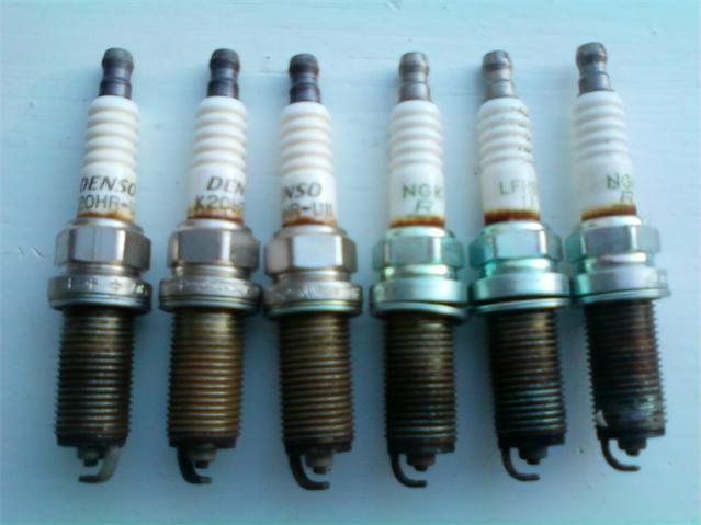

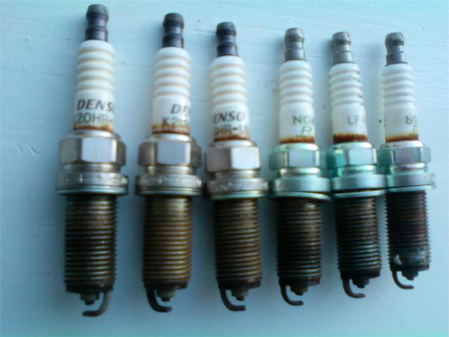

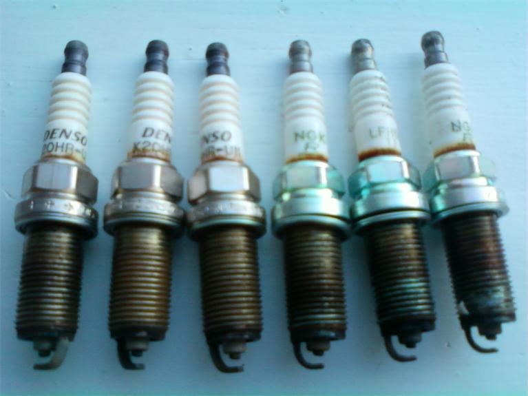

1st spark plug change in 92k miles. i was worried the plugs would corrode and get stuck in the heads.
i'll attached a picture of the old plugs 3 denso and 3 ngk, as most experienced.

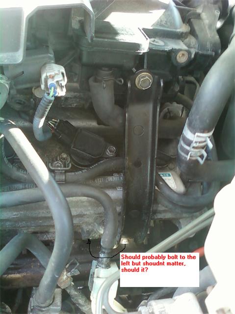

it was dark so i called it a day and fired up the ride, and drove it back to the garage. Resumed on the driver side today. the bolts holding the surge tank stay bracket were fairly tight. took quite a while to get the top one off and bottom on loosened. decided might as well remove the whole sucker to have more room - i heard most of you just loosen the bottom bolt and swing it out of the way. anyway, repeated the procedures yesterday on the driver side, except it's quite a bit slower because of all the wirings resulted in limited room to maneuver the wrench.
Got a question though. i think i made a mistake when putting the bracket back. i replaced the bottom bolt in the middle hole when i think originally it was probably on the left. didn't look like it would matter. i'll attach a picture if you don't know what i meant.
