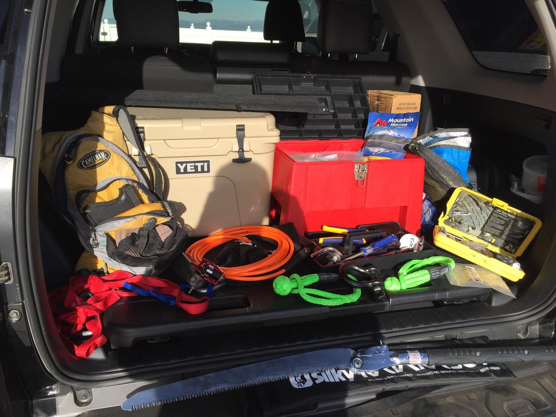

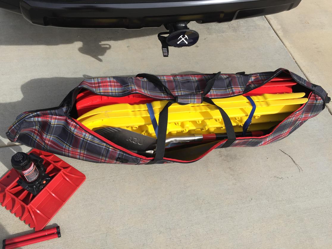

Dave, here you go....all this stuff has saved my arse at one point in time...

Nice new Gear
Thanks redkat
The only problem is this gear is all brand new. It's never been used. You need to get out more often. ... I'm in So Cal. Let's go!

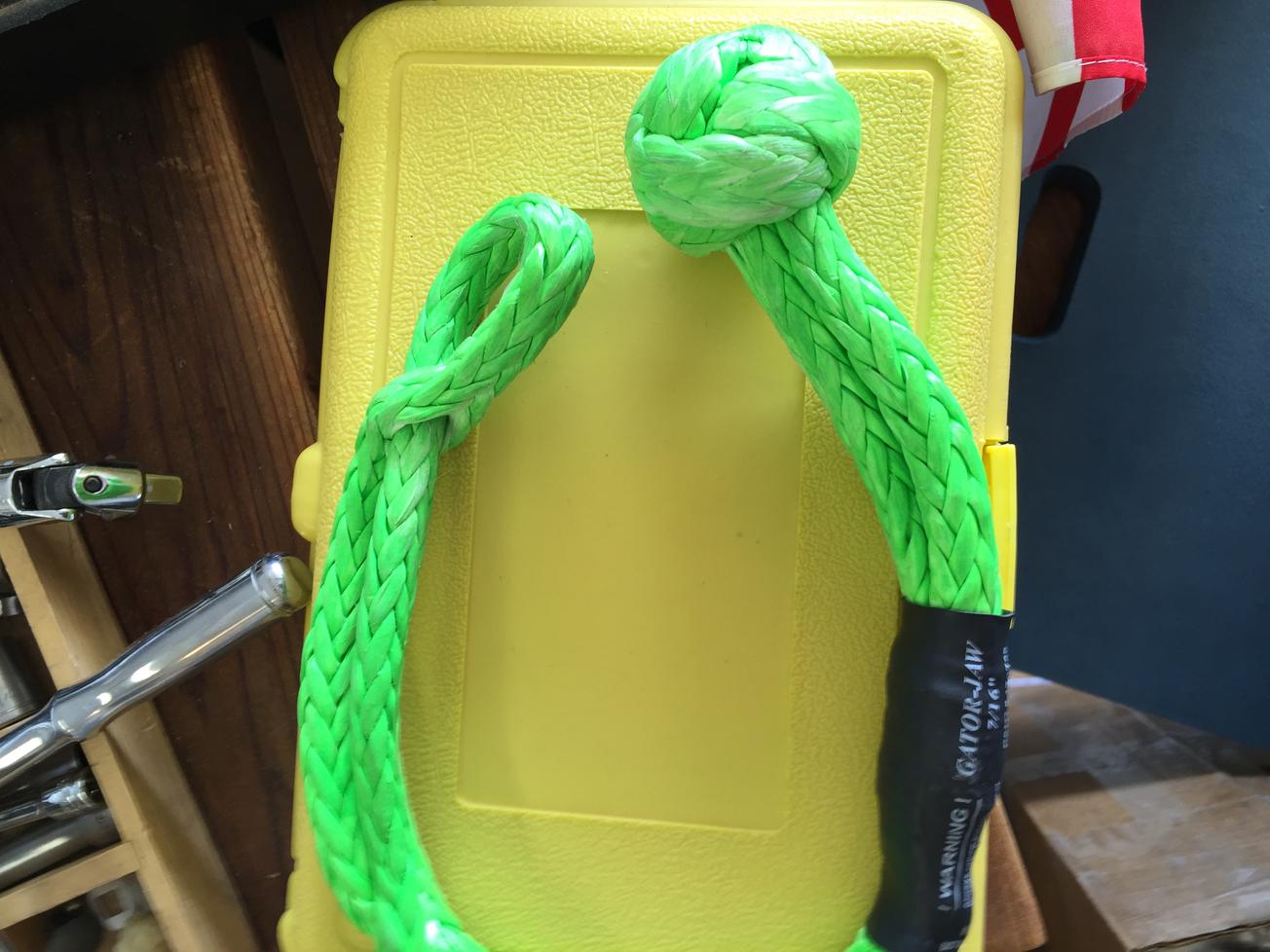

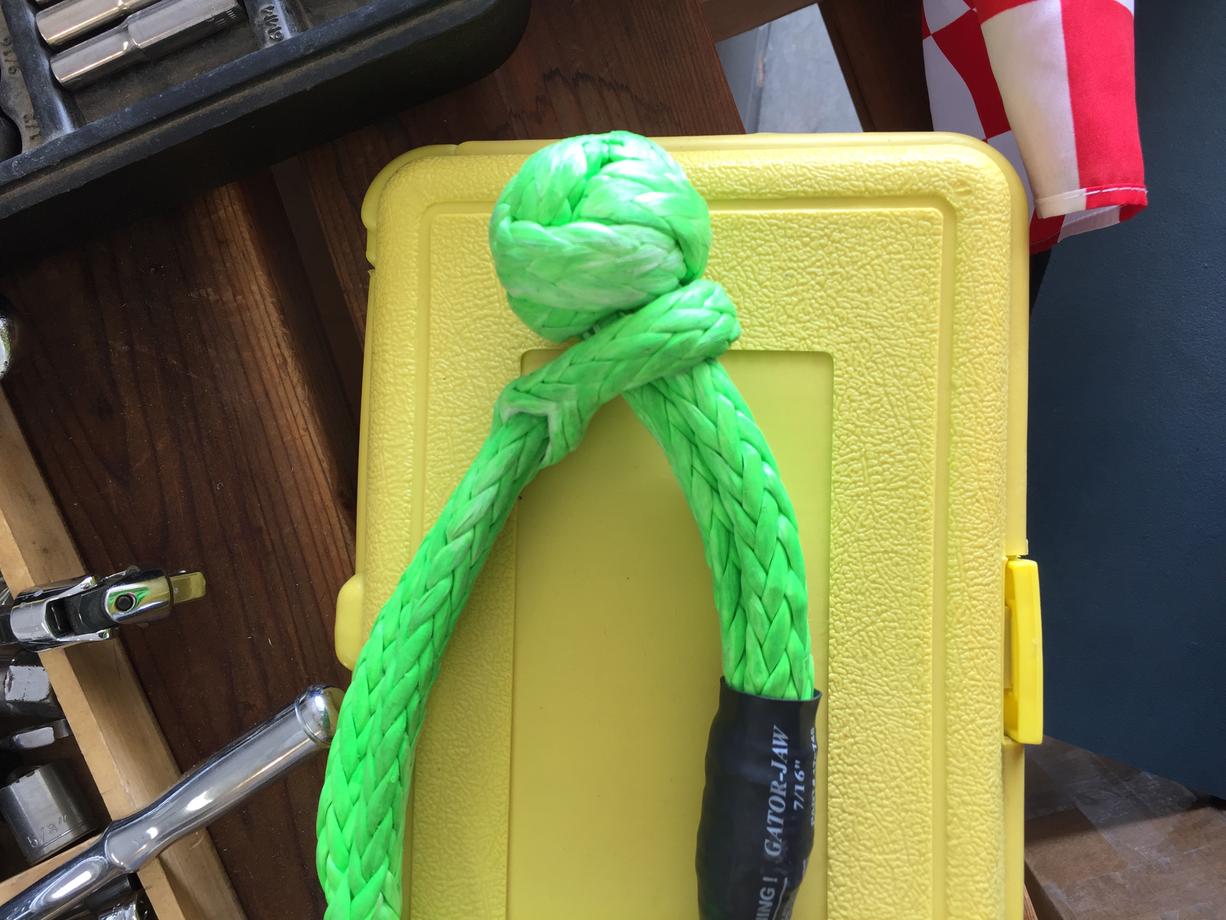

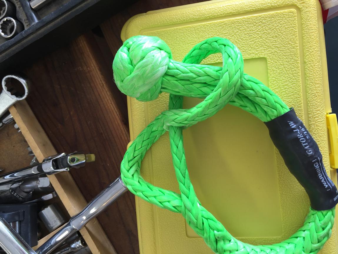

P.S. I still don't see or know how those soft shackles work. What holds that loop together?
Here's a good video on how to make your own soft shackle:
I'd keep at least one regular metal shackle with you though. Soft shackles don't do sharp corners very well.
Recovery gear should be new or near new, stuff needs to be replaced periodically esp. after its been loaded up a few times. I keep my gear clean. Recently purchased an extra set of recovery boards for Dumont Dunes. Yes, Its a good idea to practice using gear and working out possible scenarios, although every recover situations presents its unique set of circumstances. Be prepared and know your limitations. I try not to get myself in risky situations, even more so when solo.

redkat,
Thanks for the photos of the soft shackle in various shapes. Now I think I see how they work. These would be okay for joining two straps or anything else out in the middle of the rigging.
