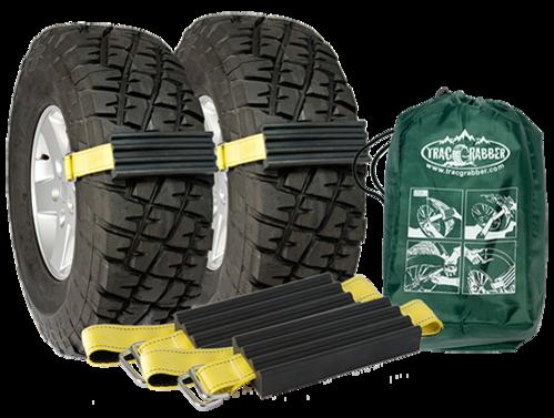

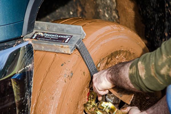

Has anyone used either of these or both? Thoughts? Seem like a great emergency tool to have. TruckClaws look to be far more aggressive (& therefore better), but cost 3x Trac-Grabbers. May have helped me get unstuck from that bigass mud pit a few months back without a tug. :D
TruckClaws 2 (Aluminum) $159.
https://truckclaws.com/emergency-tire-traction-aid/
Trac-Grabber (Rubber) $49-$99.
https://www.tracgrabber.com/

Not sure how well they'd work with my 35's... I imagine like the above poster said, it'd rip a fender off pretty quick.
The picture shows a vehicle with stock tires, most of us are trimming fenders and pushing caster and such to barely clear 33" or larger tires...

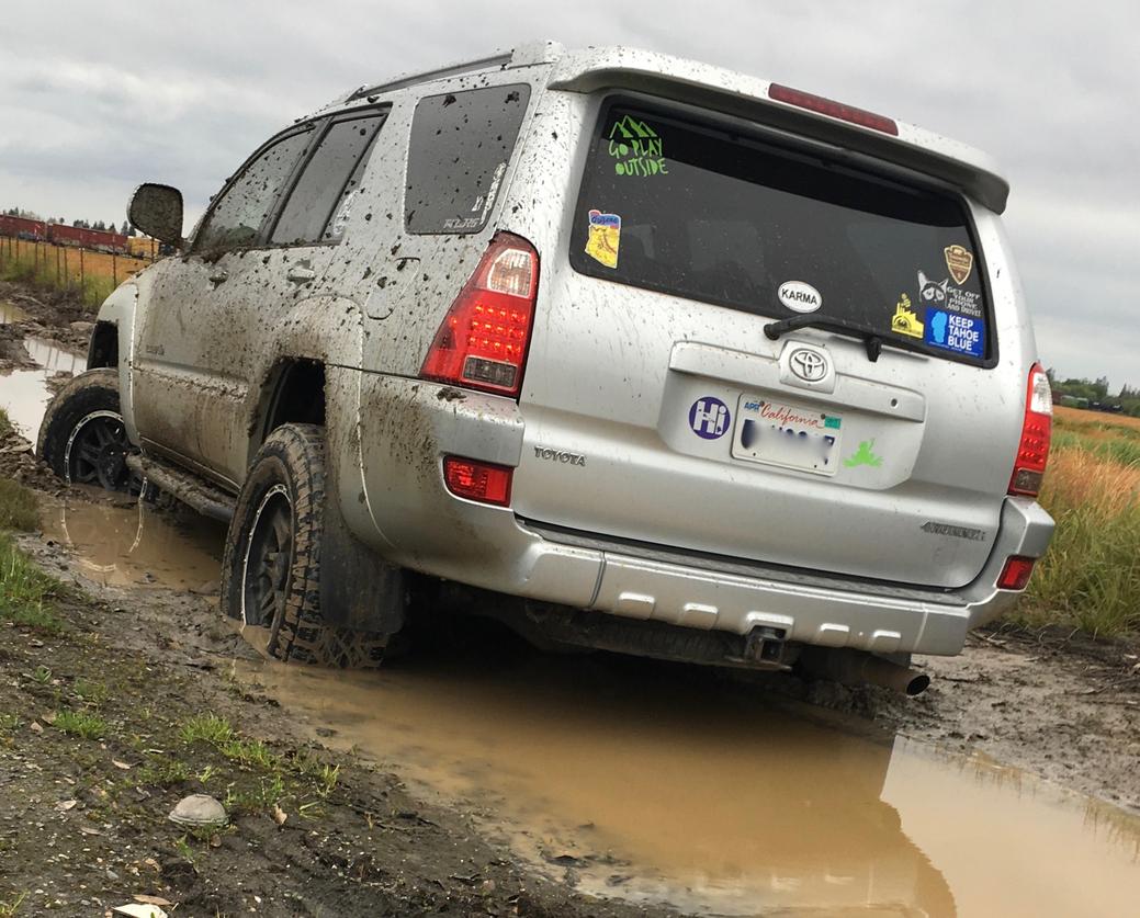

Really depends on the situation at hand. I have a pair of 4'x2' industrial fiberglass grating, works similarly to Maxtrax but costs less, which is great for firmer mud, & even bridging.
However, they would likely get completely buried underneath this super watery situation I was in a few months back. I did not have them with me to try, as this was a spontaneous mud puddle we came across. Not sure they would've helped. Had to get a light tug backwards & I was free.

Holy crap!! They've found Bigfoot in that first photo in the original post [emoji50][emoji50]
Heck, those tires in the first photo look like they barely have any tread. Don't appear like they would be good for the pavement alone going off-road.

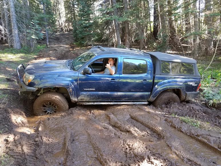

That's because they're loaded with mud. You can see the siping just barely under the layer of mud. Last time I went really muddin' in the 4th gen I had 33" Nitto Terragrapplers and they looked like slicks after getting loaded up.
Now this is loading up with bald like tires.
He did get out on his own.

No disagreement about them being loaded with mud. I have had an inch of mud caked on mine before. But that tread design is obviously not agressive at all.
I've been in muddy trails in Wisconsin and, unless you have terra tires for tractors, your tires are gonna get loaded up with mud and become like slicks whether they are tsl super swampers or bfg all terrains.

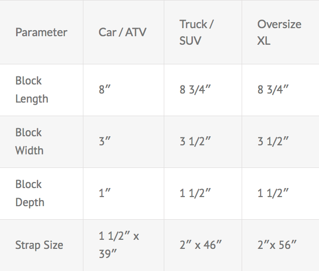

I imagine the rubber Trac-Grabbers wouldn't clear if I had 35's either, I'm just a tad over 33's. Did some preliminary measuring & guessing & it seems they *might* work with my current setup, clearing the wheel wells as well as brakes. The block height for the larger truck or oversize is 1.5". Moreso on the rears, but the fronts should clear...as long as I don't turn my steering wheel haha....

I imagine the rubber Trac-Grabbers wouldn't clear if I had 35's either, I'm just a tad over 33's. Did some preliminary measuring & guessing & it seems they *might* work with my current setup, clearing the wheel wells as well as brakes. Moreso on the rears, but the fronts should clear...as long as I don't turn my steering wheel haha....
Something else to consider is that even with my 33's, when I was stuffed they ripped out screws from the back mudflaps. So even the rubber stuff can catch objects on there.
id buy fake maxtrax before i buy those. Those look like they can do some damage to the fenderliner if your tires stuff into the wheelwell.
Also, trying to install that while your knee deep in a mudpit..yea ill pass.
