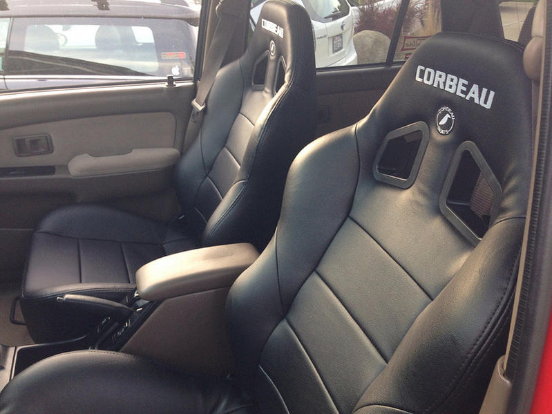

Corbeau Baja XRS on Wedge brackets?
What are the brackets...
How was the install?
Plug N Play?
Cost?
