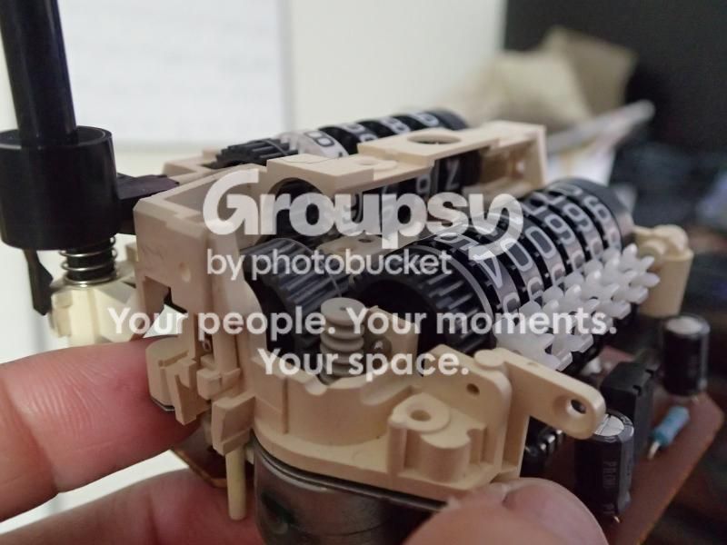

Mechanical or electronic?
ie:
P5052404_zps49f8b894.jpg~original
Know what you mean, I replaced the odo/trip odo mechanism because of a broken part of the trip odo which prevented the odo from working. The 'new' one had 77,xxx miles, I had 261,xxx miles. The two parts separate so I replaced the trip odo and kept my mileage. :D Looked like I could have used the auger on the 77,xxx mile one to change it, but that would have taken a bajillion years! I didn't dig further because of the easy swap.
