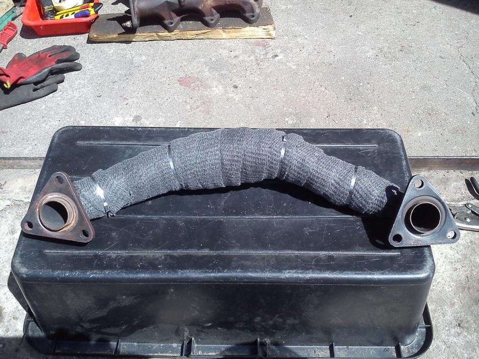

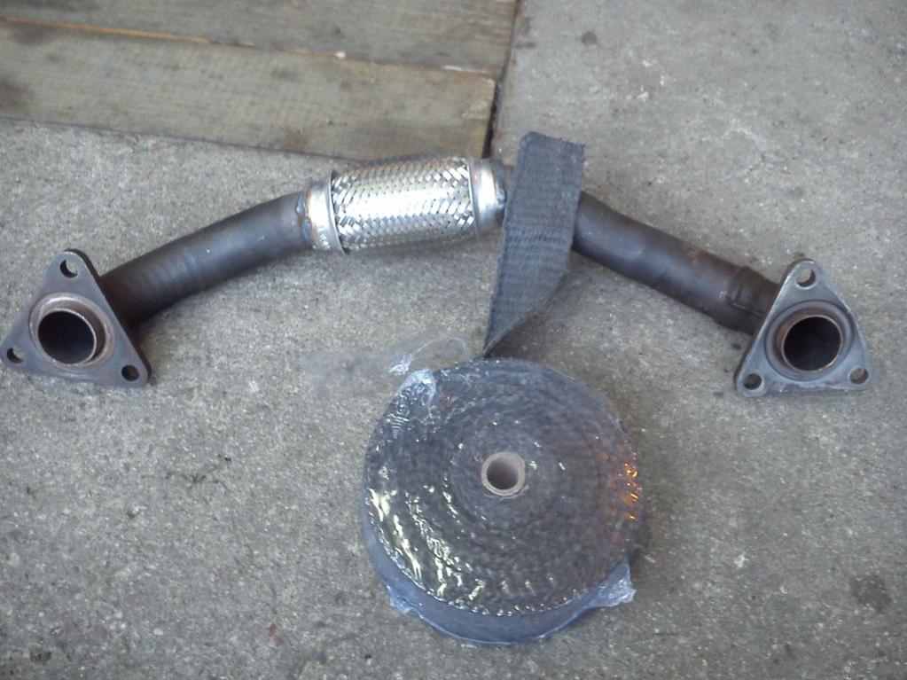

Crossover pipe has a elastic corrugated tube covered by a sheet metal. Remove the sheet metal and replace elastic connection with similar one. The same that is used in exhaust pipes. Wrap arround the crossover pipe with thermo bandage.
Elastic corrugated tube will give you this missing milliliter :)
Here is how i did it:
Thanks for the reply and photos! I will see about having the thing cut down and that section replaced. I had assumed that bulge was simply a chamber for noise control or something.
