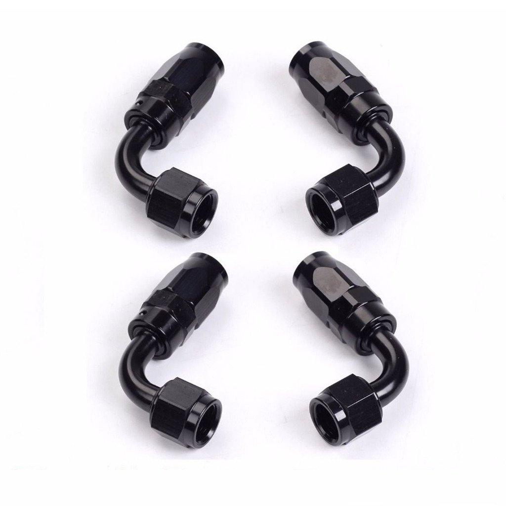

I just need to get hose and AN10 hose fittings, like these 90-degree ones

I never had luck with that style of hose end. I ended up paying up for Aeroquip push-lock stuff. Guaranteed not to leak at the hose-to-fitting joint. Then you just have to make sure your NPT joints don't leak... Though that one looks like they are o-ring style fittings to the adapter.

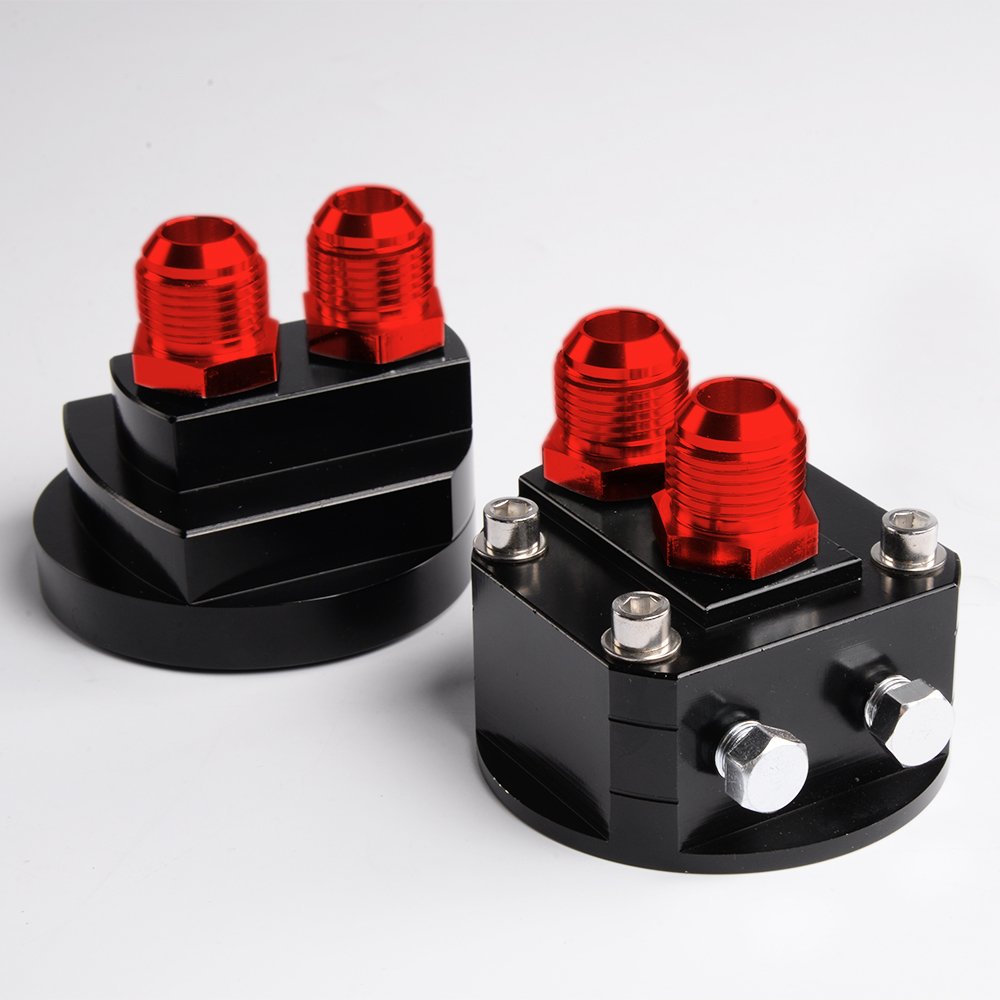

I like this for the oil filter adapter: https://www.summitracing.com/parts/mor-23682/overview/ Don't scrimp on oiling parts... or you will be doing it over to fix problems.

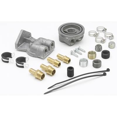

Hayden makes a kit part # 291. It comes with everything but the hoses. I like Hayden's transmission coolers and I have one of their electric fans on my jeep. I think the make good products.

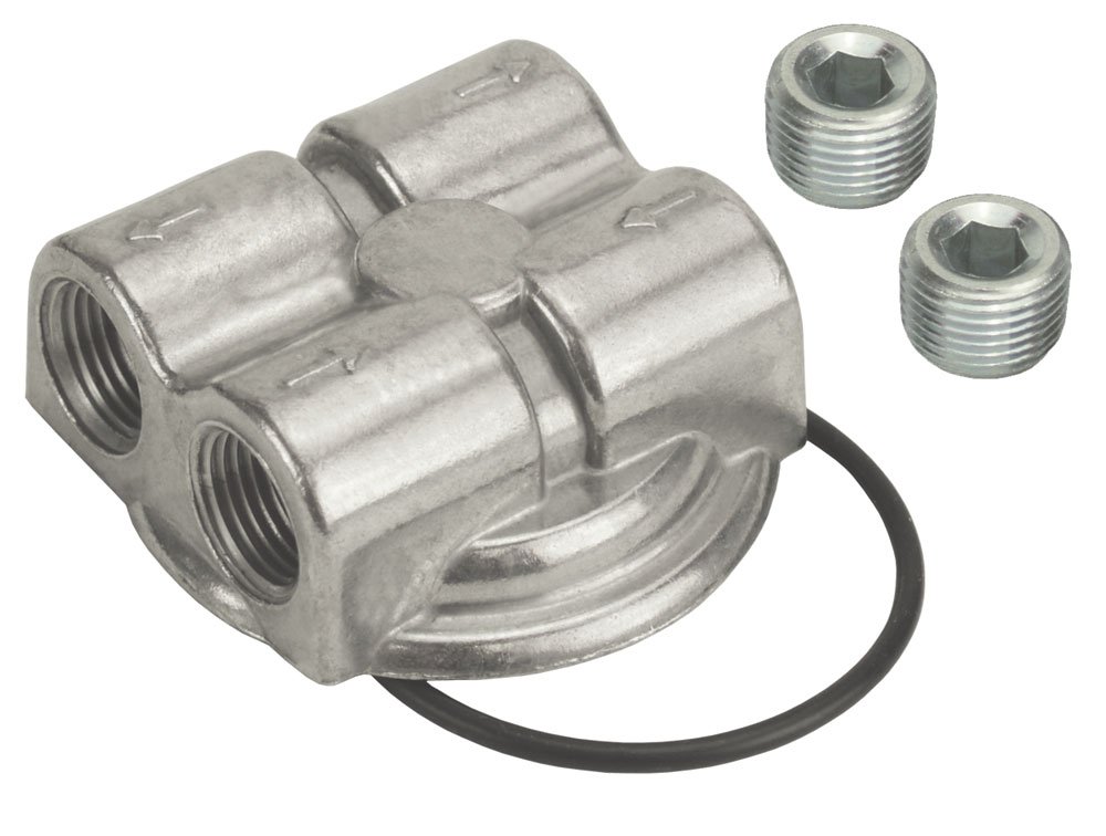

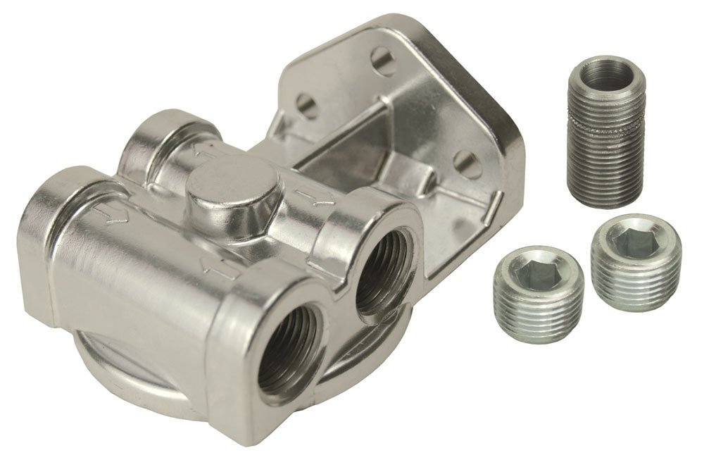

Went to my storage today to look for a few bits and found I had a few Derale remote oil filter kits like this left over from projects.
Just need a sandwich adapter like this one

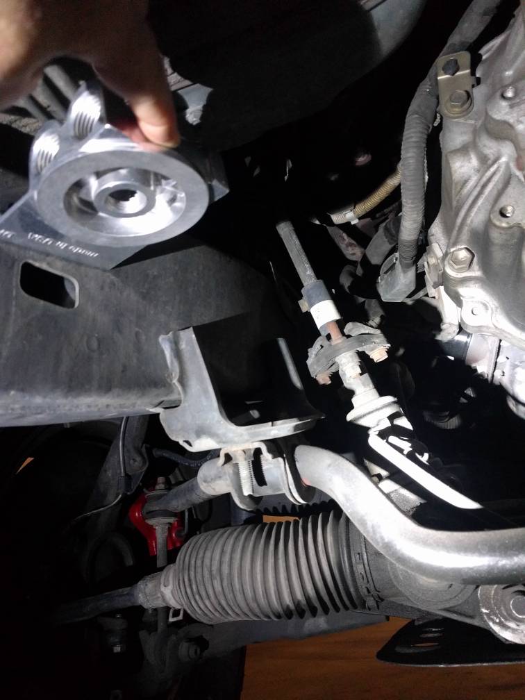

And I was looking at this location for the remote mount
I figure the hoses could route back along the block and bellhousing then swoop away towards the frame. I'd fab up a bracket to support the hoses and mount it using the bolt that secures the other bracket visible right in front of the bellhosing bolt on the right.
Sure would make changing oil filters easier and it would be out of the way from road debris for the most part.
