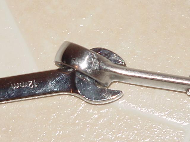

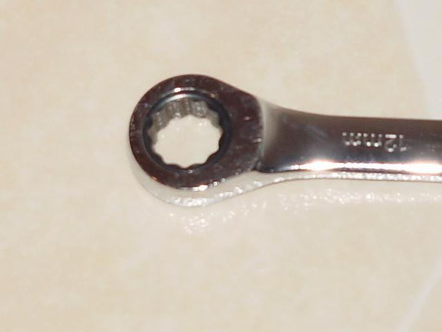

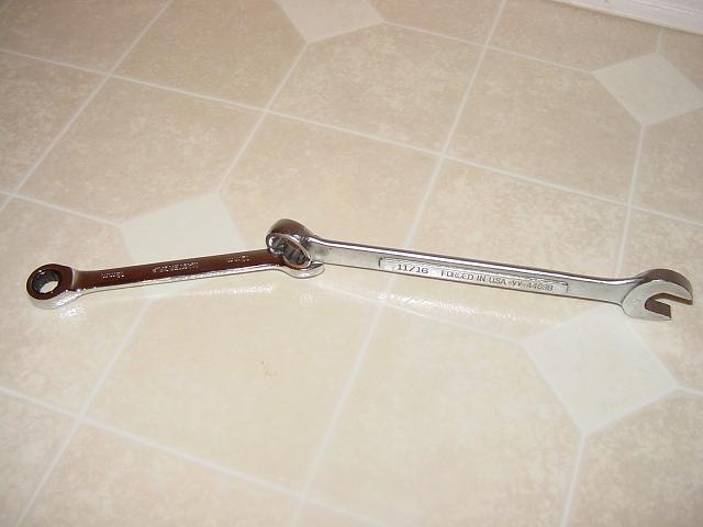

....Ron, I've forgotten the exact size of those bolts. But if my brain serves me right then they are 12mm (Metric). Remember, I've helped a neighbor to temporary fix his broken muffler on his 05 Sport just few days before New year. Yes, those bolts are very tight. specially, his car is one year old. I do have air compressor with a mini impact wrench, but it didn't work. Here what I used. Spay lot of WD-40 over the nuts and bolts. Use one ratchet wrench serves as primary, and a regular box wrench serves as extention bar. Place the ratchet wrench onto the bolt that need to be removed, swing the primary to the best openning position, then connect the box wrench to the open end of the primary wrench in the interlock position. Hold your breath and snap it. It worked for me so goodluck. Look at the pics below. BTW, i'm still waiting for your PM since Jan/19.

...Last one. This is non-reversible ratchet wrench. The Reversible wrench is more helpful.
