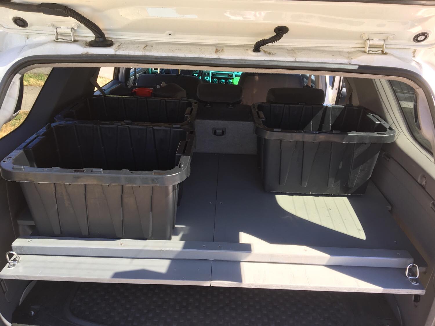

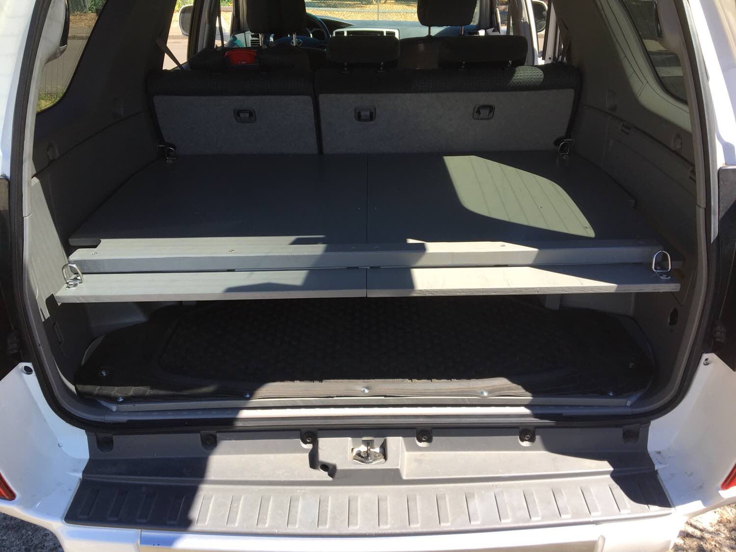

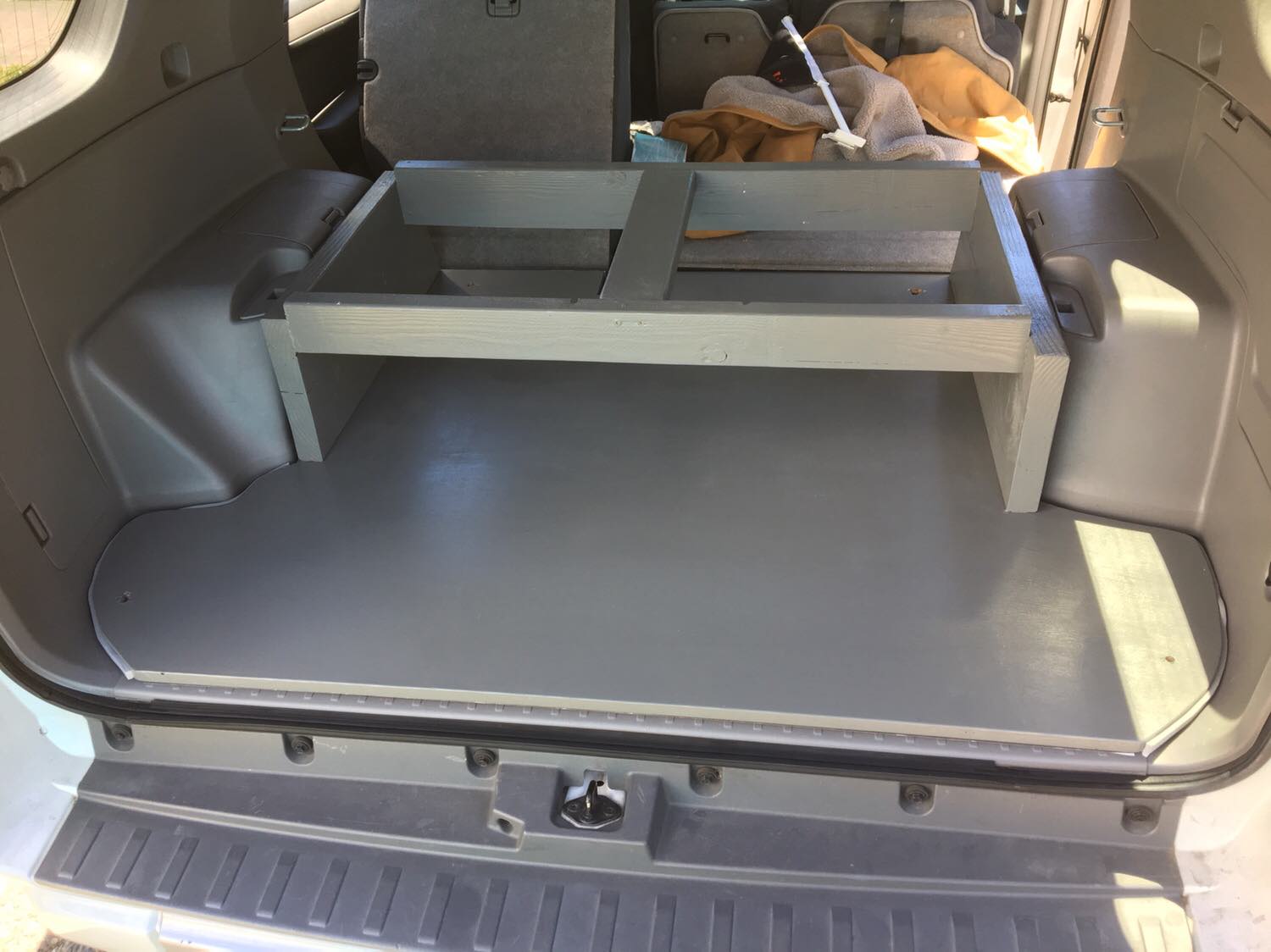

I removed mine after years of hating the storage/ crap always falling off and not being able to fully use that space! I built this 2 story shelf out of 3/4 plywood and installed it using the bolt holes in the floor the SD shelf was in!
I put my tool kit, air compressor, survival essentials and other things down below that are not used everyday. The bins in the top can be used for groceries , car parts or can be removed if you wanted to put something larger back there like suit cases or other things
