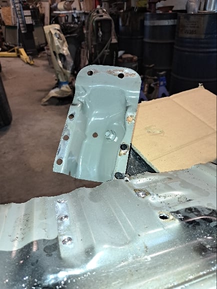

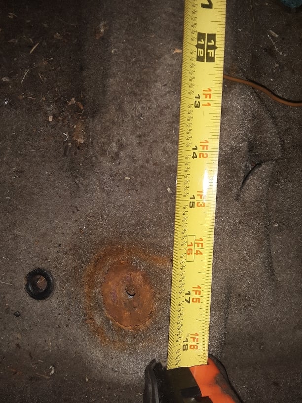

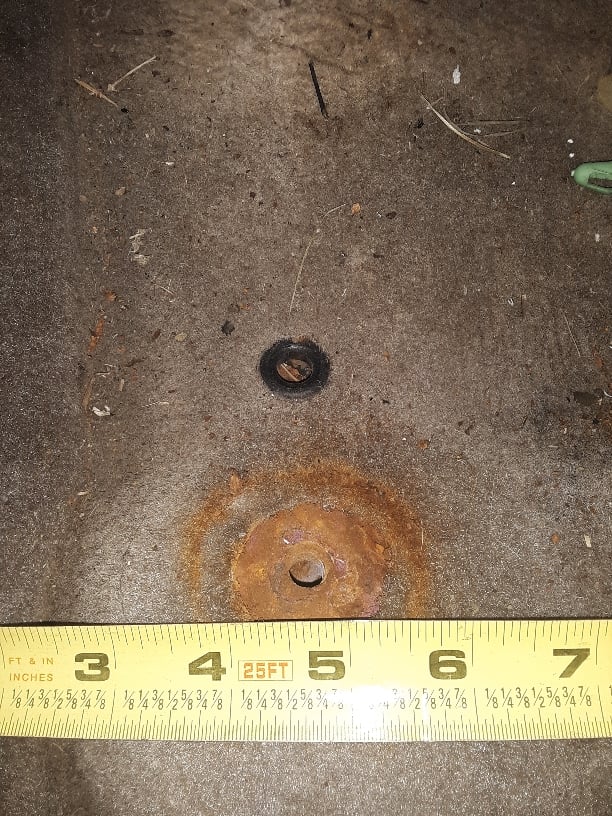

the welded nut for my driver's seat is now loose and was wondering if somebody could kindly measure the original center-center spacing of the two front bolts of the driver's seat? the seat frame on mine is wiggling so i can't base the correct measurement on the seat frame.
i'm planning to weld a nut to a piece of sheet metal and weld it to where the nut was originally welded.
Thank you.
From the center of the other hole and from the pinch weld of the rocker. :)

I welded mine to a washer then drilled and pop riveted it in. I would weld it in after in place though. Pop rivets can wiggle some ad welding is solid. That crossmember the nuts are welded to inside is kinda on the thin side. These nuts never should tear through. Design flaw.
