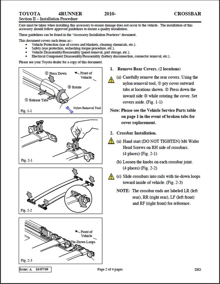

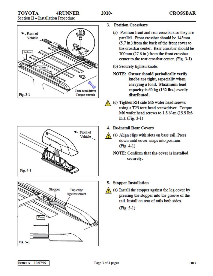

I have the 2010 4 runner and want to remove the luggage cross bars. Does anyone know how to remove the cross bars?
Here you go check out these screen shots.
