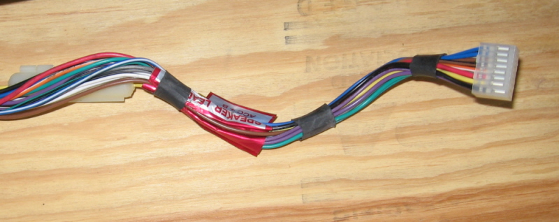

Well here is the picture of the harness for my eclipse HU. It's still hooked up to the harness for my 94 Ford Ranger, but that will be undone as soon as I can figure out what harness I will need. I would just cut the factory harness on the T4R but I don't want to void whatever warranty there is for the T4R.
