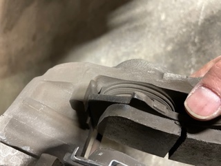

IIRC they did not have a separate anti vibration pad, it is bonded directly to it. I found a picture I took during the install that leads me to believe that my memory is correct. I also noticed on the box that it says "hardware included if specified by OEM". HA!

First, do not use standard bearing grease - or any other regular grease for that matter - on brakes. The high heat generated in the system will cause the grease to break down (bad) and possibly run down on the friction surfaces (even worse). Here are the only two products my son recommends for use on Toyota brakes:
As for the hardware kits - Toyota calls them Fit Kits - my son had some more advice based on personal experience. He does not recommend or use aftermarket hardware due to poor fitting parts. He got burned a couple of times on his own car and a few others he worked on and had to install the OEM Fit Kits later to rectify hanging pad issues.
