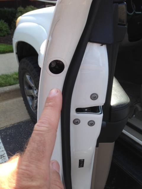

Aligning the lock mechanism with the actuator was a real PITA....until I found out you can easily remove the lock mechanism from the door which then makes alignment a breeze.
On the end of your door there is a rubber plug covering a torx bolt that holds in the lock (see hairy finger pointing at hole).

Look at my last picture and remove the torx bolt you see in there. This will allow you to remove the door handle lock. If you put things together correctly inside of the door, it should be pretty obvious what needs to be aligned with the door lock. It's been a while since I did mine, but I *think* the acutator motor (the part you replaced) essentially has a slot in it that should align with the key-lock mechanism (the part on the outside on the door handle). It's easy...take that torx bolt out and it will all make sense.

I just bought a used 2014 and had this issue. I took off the plug, unscrewed the star bolt, lined up the rod properly and now it works like it should. When I looked in the hole I could see the rod was not level but pointing upward. I didn't have to take the door apart at all.
