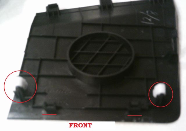

The speaker grates can be removed with a very small screwdriver. I added electrical tape over the end, but it kept pulling off so I carefully worked without it. Use a very small screwdriver to pry up the front, enough to then use a larger screwdriver to finish popping up the front.
The two catches you need to pop out are shown below with straight red lines, about 2 inches in on each side. You can release the catches by pushing forward toward the windshield, then prying up. The two red circle catches on the sides (with white clips) can't really be touched, so just leave them along and theyll pop out just fine.

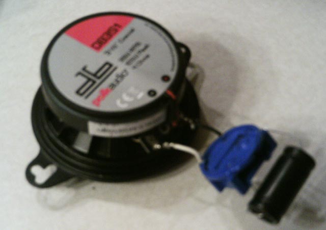

Remove the blue female plug socket by prying back the little white catches; there's also a soft adhesive that holds the socket on to the back of the speaker. Unsolder the black and white wires from the speaker (if you don't have the ability to solder/unsolder, this whole project will be almost impossible). Discard the old speakers once you have the new speakers working. Once you see the old-world quality and workmanship of the original speakers, you'll have little regret in discarding them. The DB351s are 2 or 3 times as heavy as the original speakers.

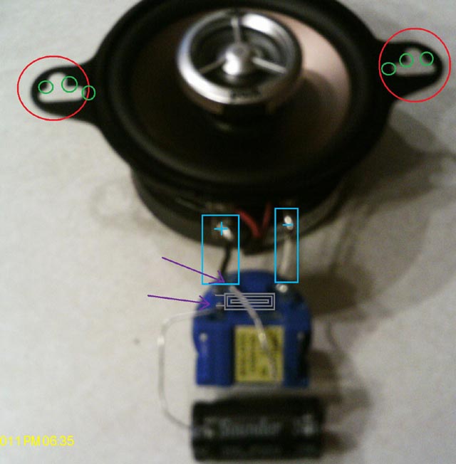

Solder the black wire to the + terminal of the new speaker, and the white wire to the other terminal. Also (this step is probably optional) unsolder the small black capacitor on the blue socket and remove it. Using the large black capacitors included with the DB351s, solder those in place instead. See photos below.
In the next photo, the spots where the original capacitor was attached are marked with purple arrows, and the old capacitor marked with a gray square. Also note the red circles on the speaker mount holes: you're going to want to dremel off those corners marked with green circles, or fold them down with a needlenose pliers (I used pliers). But you will need to dremel away some metal on the green circle closet to the speaker: the holes on the DB351 don't match the original speaker unless you a) dremel the holes bigger and closer to the speaker, b) very slightly bend the speaker brackets wider, and c) grind off some sections of the original speaker brackets (remember when using the dremel on the speaker holes that during the process you'll either have to cover the magnet with a bag or when you're done remove the metal shavings from the magnet using duct tape. They'll stick like...well...a magnet.)
Now plug in the speakers and test them. If they work, unplug them again, cover the exposed wires on the capacitor with electrical tape (optional), and on to the brackets.

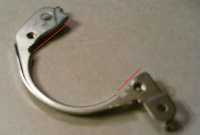

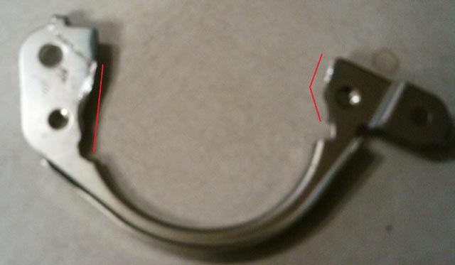

Both brackets have to be very slightly bent to widen them (but not too much) and some of the metal needs to be ground off. You can put the brackets next to each speaker, compare, and go back and grind unti they fit. You have to grind away more on the left bracket than the right, so be careful you don't weaken it too much. If I did it again, I'd probably add JB Weld on the weak points (optional). I had a grinder available right there, so grinding it was easy. The places where I ground away material are marked with red lines in the images below.
How much do you grind away? Simple: enough so the bracket fits nicely against the speaker base (not the magnet, but the metal frame/base) but the holes still line up from speaker to bracket. You're basically expanding (via grinding) the arc of the original circle to be a slighly larger circle.
