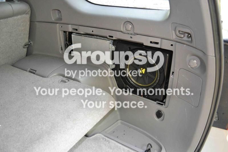

All I want to do is change out the subwoofer in my 2006 Sport JBL 4Runner. Spoke to Crutchfield for the easiest solution and I ordered the Rockford Fosgate and was told it would be a simple "plug & play" no amp replaced & with the greatest potential difficulty drilling 4 new holes if the holes did not line up... with that said I thought all I would have to do is remove this panel and not have to pullout the rear corner interior... am I wrong? How do I remove just this one panel without having to pull apart the interior corner.... Thanks!

I do not think that panel is removeable on a JBL equipped 4runner. It looks to me like that is a non-JBL 4runner with the sub swap. Here's info on accessing the sub for a 4runner with JBL.

You can't remove that panel by itself without breaking it, the tabs are glued at the top. You have to take off the whole trim piece
