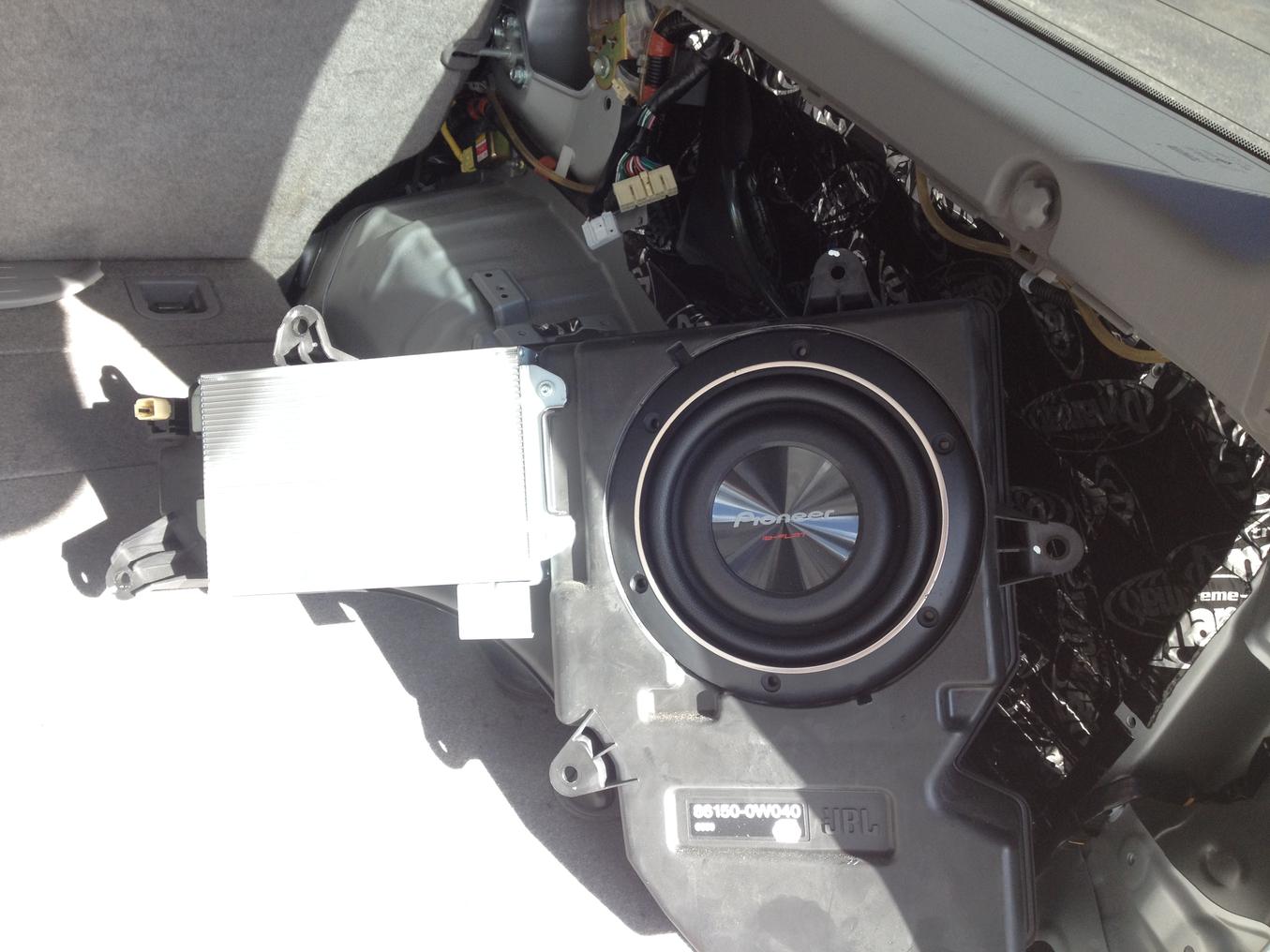

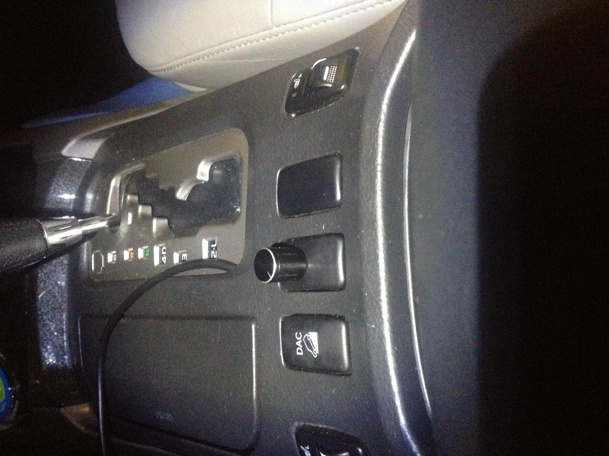

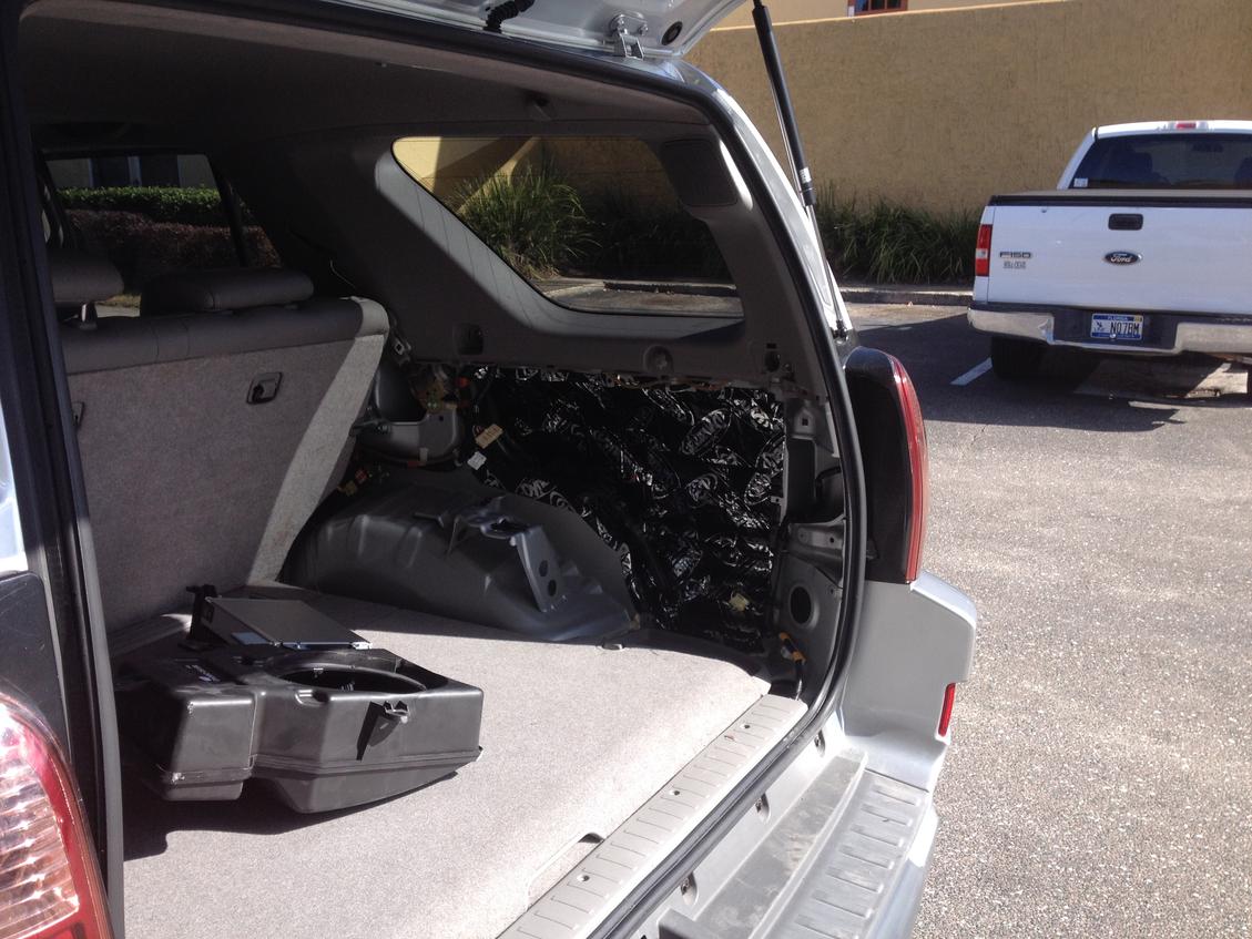

Thanks for the inspiration ARK_SWAMP_RIDER, I replaced the stock sub with a Pioneer (TS-SW2002D2), no cutting required, slipped a Cobalt 3002 Amplifier under the passenger and dissected a universal bass control to fit into one of the blank center console buttons. It took all day yesterday to complete as I didn't want to "half-ass" anything, and so all wires and aftermarket equipment are hidden. I'm not sure how it'd sound without sound dampening material, but I didn't chance it as you may see in the following pictures. Sorry for taking only 3 pictures, nothing was left loose...
What is that ugly wire coming out of the console? You say you didnt want to half ass anything but whats that about?
It's my iPod cable that integrates with the stock JBL head unit. That was a completely different, half-assed project, but thanks for reminding me about making it covert...
