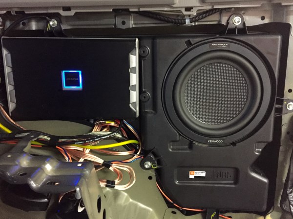

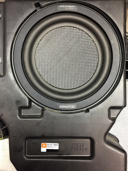

I recently replaced the whole system but the sub was a Kenwood KFC-XW800F and a 5 channel Alpine PDR-V75 5 channel amp.
Sub was a straight forward drop in. No modification of any kind. I did put in some dacron to dampen the box though. Works great and lots of thump.
This setup looks nice, that is one pricey Amp (at least on Crutchfield).

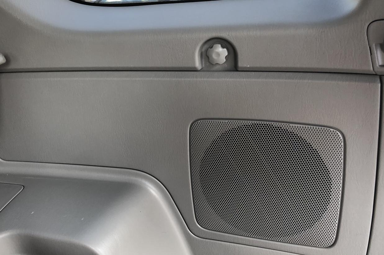

2007 4Runner blew its sub today. Rattling pretty bad. I got a Pioneer TS-SW2002D2 8-inch Shallow-Mount Subwoofer with 600 Watts Max Power to replace it. Looking in the back I see there looks to be a panel that pops out instead of taking the whole panel off. Is that possible or do I have to remove the whole side panel?
I would like to cut the wire(s) to the sub woofer if possible, not looking to dig into the panel, is this possible. Any help appreciated.
