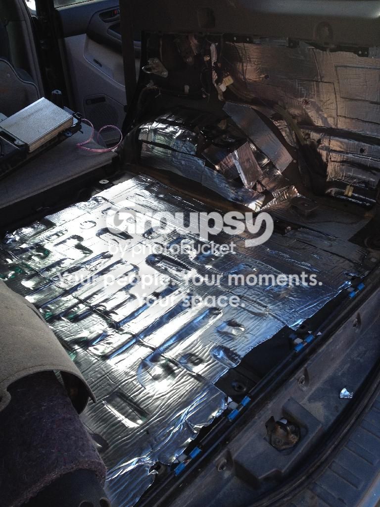

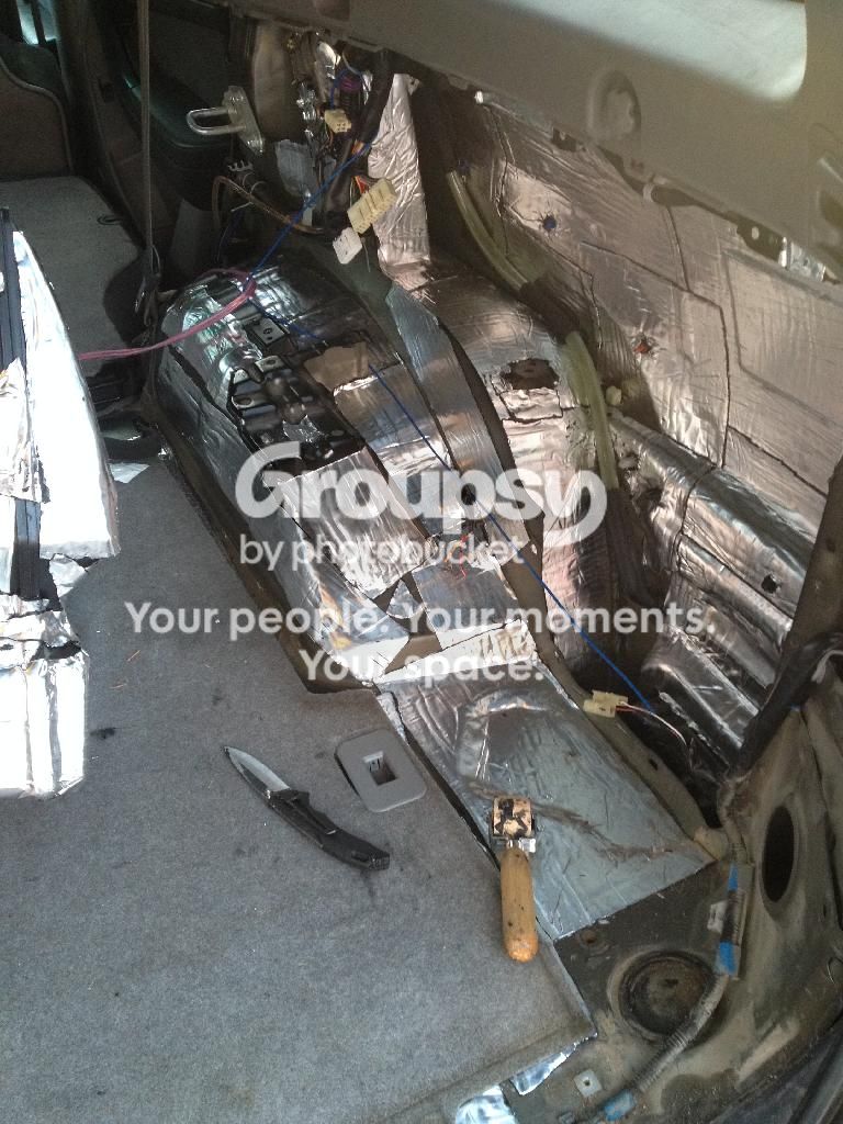

I pulled it all apart today and went over it with a fine tooth comb looking for rattles. I pretty much dynamatted the whole area. I found the best improvement was from totally covering the sub box in the sound dampening material. The sound now is MUCH better. If you want more bass I highly recommend spending an afternoon sound deadening the sub area. I covered the inside panel, wheel well, sub enclosure.
And I figured since I was this deep I may as well sound deaden the cargo area. Someone said once it was good bang for your buck to reduce noise:

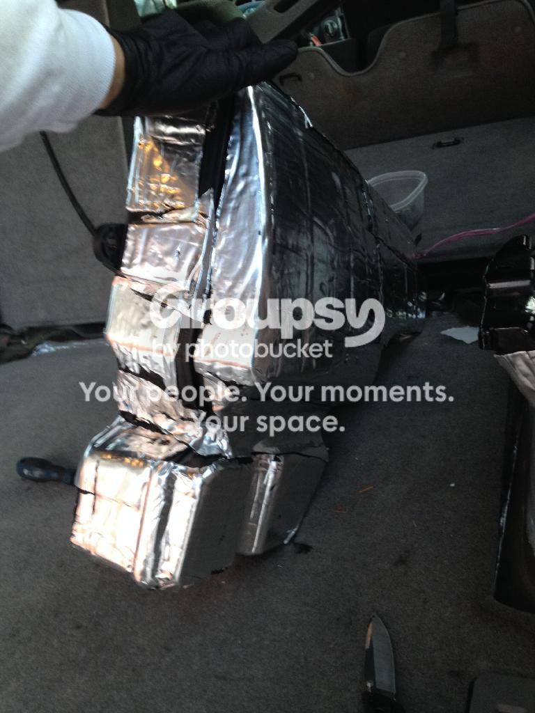

It made a real big difference deadening the sub box:
So I found the worst rattle is the seat belt wheel in the back cargo panel. I put deadening all over this and the area but it still rattled lots. I figured out if you keep the seat belt locked and plugged in to the latch it keeps everything in the wheel tight so you don't get rattles.
Final verdict is that it sounds AWESOME. Bye bye rattles. Hello deep bass. Very happy.
