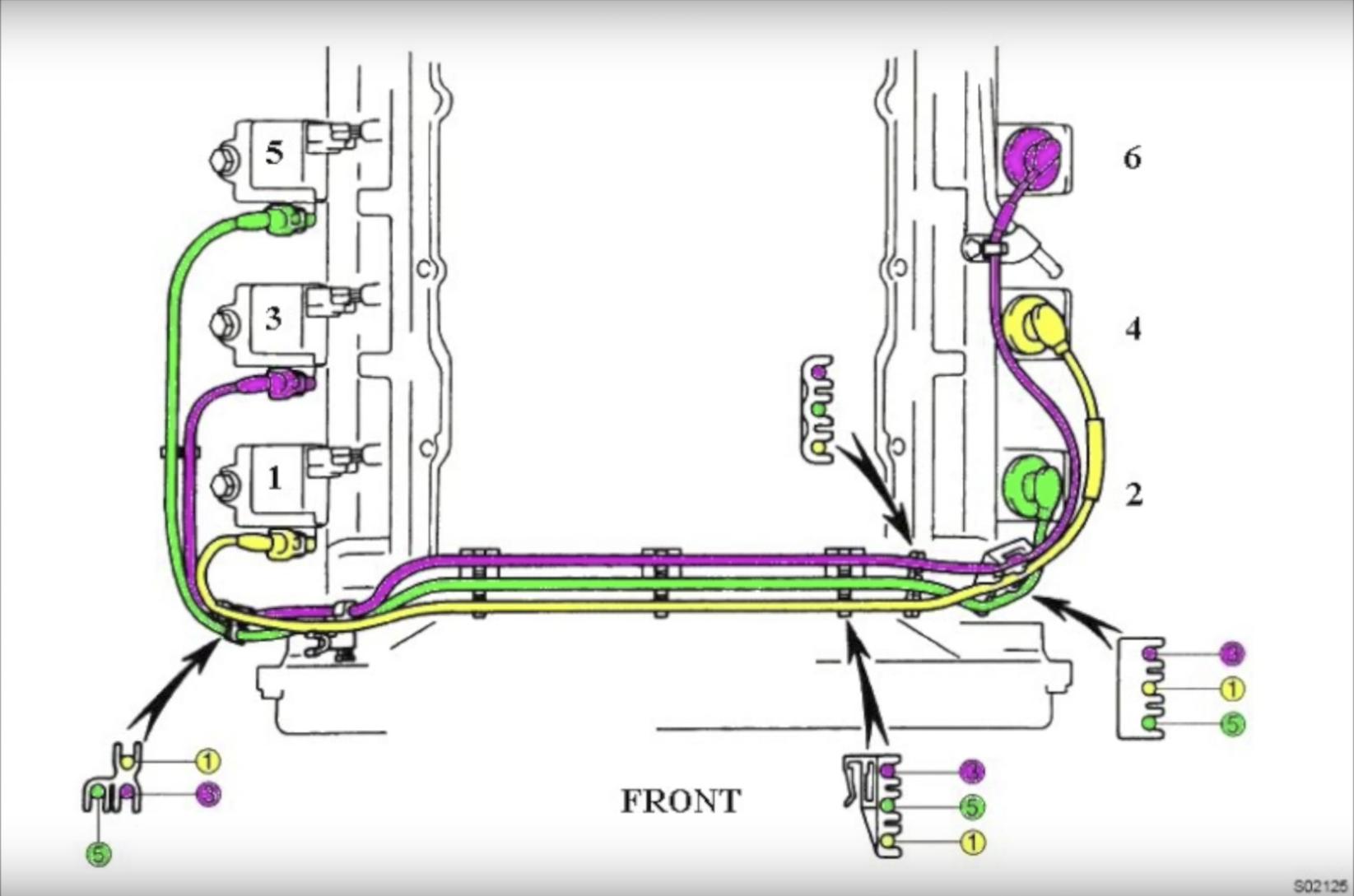

[MENTION=95183]octanejunkie[/MENTION]s question is a good one and suggestions by [MENTION=172415]tarsun[/MENTION] are on target. Did the new coils come with new coil boots? They usually do. If not, that's a question. Make sure that you have the spring up inside the coil boot to contact the plug (visual check with flashlight). Generally don't have to regap the plugs - did you do that?. Also, if I was replacing coils & plugs, I would generally do the spark plug wires as well but wouldn't think that is your problem unless the plug boots tore when you were removing them. Wiring diagram attached to check your routing.....
