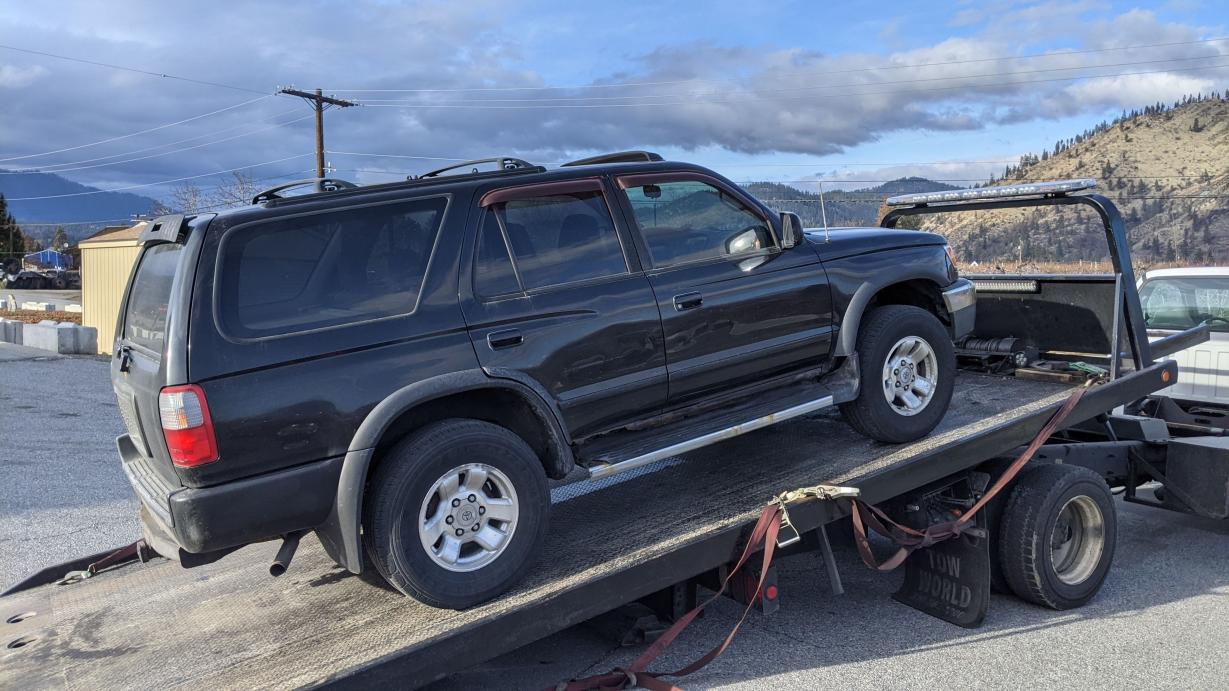

Well latest update is the eBay head I bought is cracked.. So I guess Ill be having it towed back to my house and either attempt to repair it or sell it for whatever I can get I guess.
Ive done engine work on motorcycles before but I tend to be really bad when it comes to trying to drill and tap. I dont have the patience to go slow enough and mess things up..
It will definitely be worth attempting to repair myself though I think but I have no idea which of those kits I would need?

I first need to get the truck back home and bear in mind it's December and not everyone lives in Socal.
I'm thinking on shit as I'm typing... The money and time is what I have to lose but but yeah hopefully I can maybe just maybe be able muster up enough courage to try it but maybe pay some people to tell me I'm good enough and I matter while I completely **** up drilling out the threads lol.
I'll get some pics up when I get the truck home

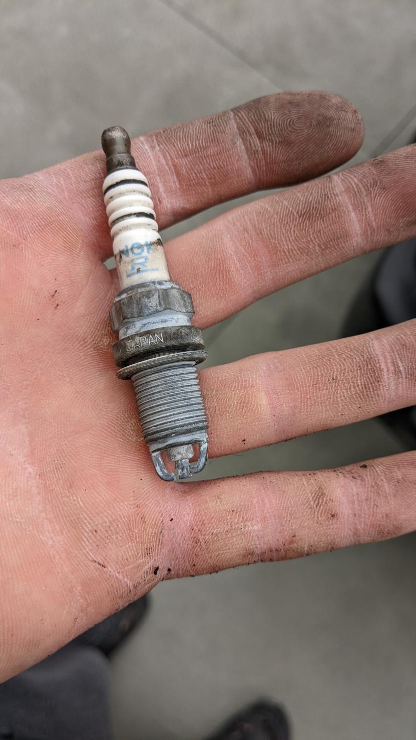

The cylinder that ate the spark plug electrode…….was that the cylinder that blew out the spark plug?
Im pretty sure that was drivers side and this is passenger side but I didn't document it. Figured the electrode just went through the exhaust valve with no ill effect. If it was the same you think it could be related somehow?

Sparkplugs generally do not fall apart sans a China knockoff.
Detonation will wreck a plug if it’s prolonged. Toyota does a poor job of watching it and only cares about it at higher RPMs. It also does poor at detecting misfires.
Add to it we only have one O2 sensor minding both cylinder banks. So if a injector starts clogging it ends up richening up the entire engine to make up for the lean mixture coming out of that one cylinder.
That still lean mixture could be causing detonation as an example.

It was a genuine ngk plug, only plugs I use. I did have intermittent O2 sensor lights come on years ago but were self resolving. Hadn't come on within a few years of this incident. It was running great prior to this occuring just like this last time. I think I'd notice a poor running condition before a related failure would occur?
You may not notice knock/detonation.

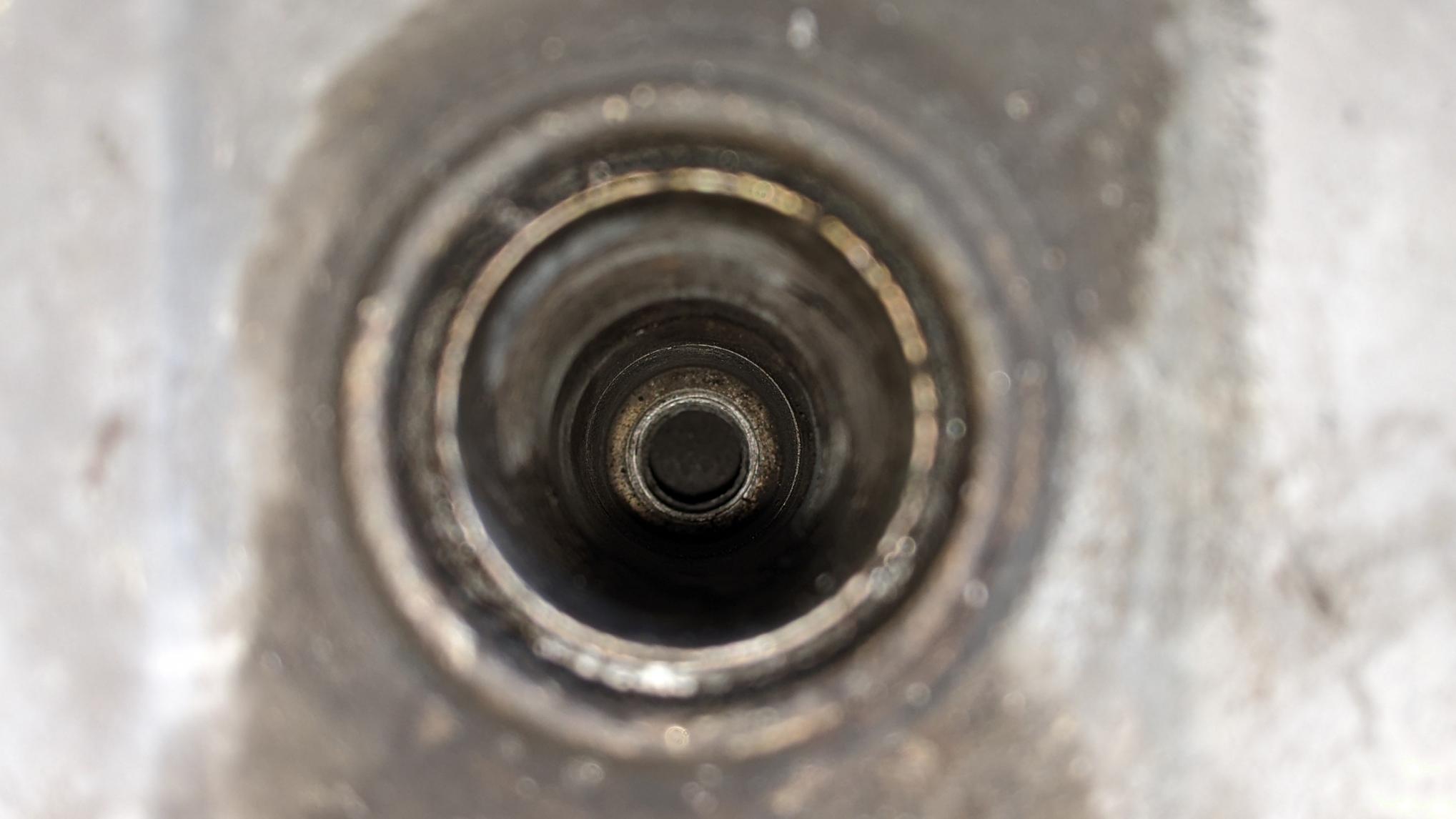

My runner is back in my driveway now. Will be inspecting tomorrow weather permitting. Also I had a good conversation with another mechanic today regarding helicoil/timesert fixes and the point at which the threads are damaged that the sleeve must become too large in diameter with too little to grab to withstand the pressure of detonation to not blow out. Thus somewhat coming to understand what the original shop could be saying but will still verify this myself.
So the shop I stopped in at had a customer with a 97 4runner, body looked mint with blown head gaskets at 160k miles. They pulled the heads, both cracked.. damn

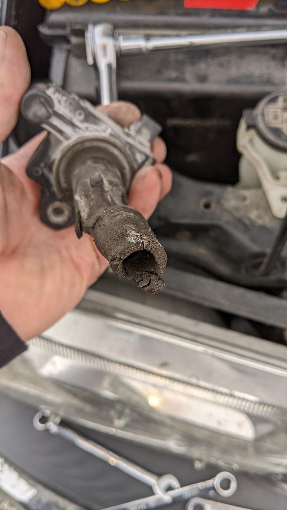

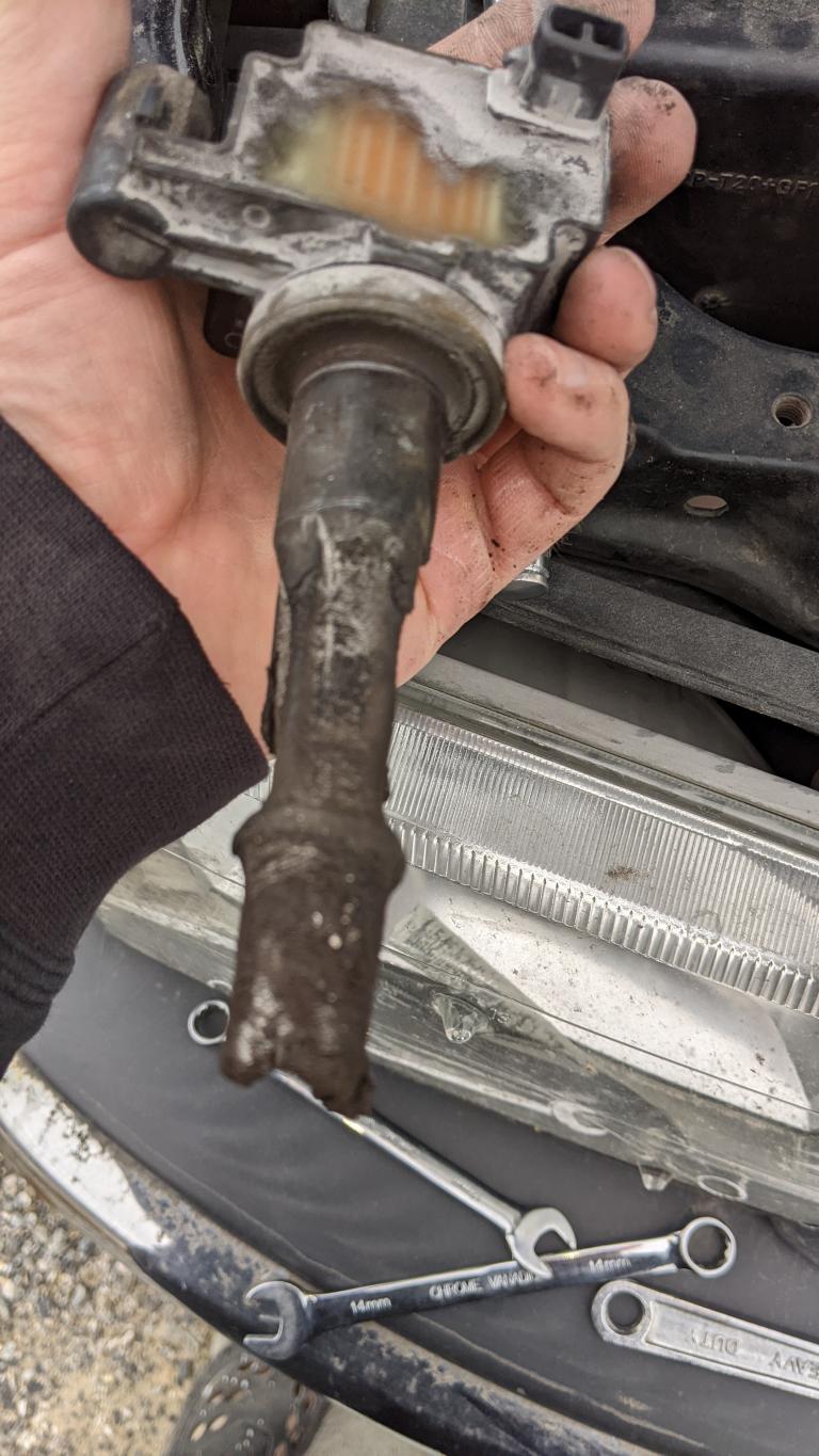

Passenger side, middle cylinder is where we have the destroyed coil pack and yes the threads are damaged to where the plug would just rattle around in there. Would take a large tap to ream that out.
Maybe that spark plug indicates detonation/knock? The strap is pretty much on the electrode

The coil pack. So the shop didn't disconnect the battery but there is no power to anything. I'd like to get a CD out of the deck, is there a main power fuse or something they pulled? I had a new battery so that shouldn't be dead..
