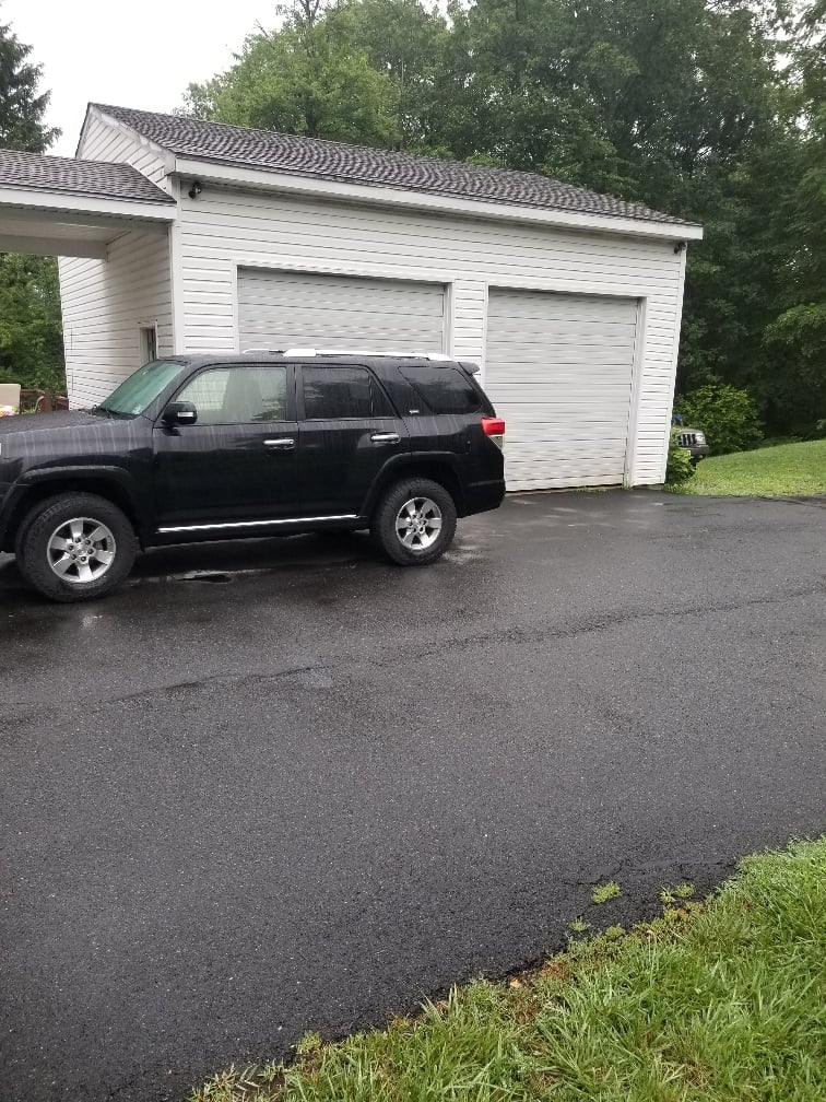

The first one likely dates to 2003, shortly after I purchased the house. It shows the original door.
enhance
All I can say is note the height of the door in relation to the roof line above it and the window to the side of it.
