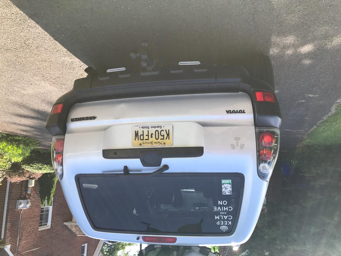

I attached a pic so you can see where i put the lights. It pretty much the same spot everyone else puts them. I was thinking about getting cubes and making them flush in bumper but with 3 jobs it a little hard to make time to work on the runner

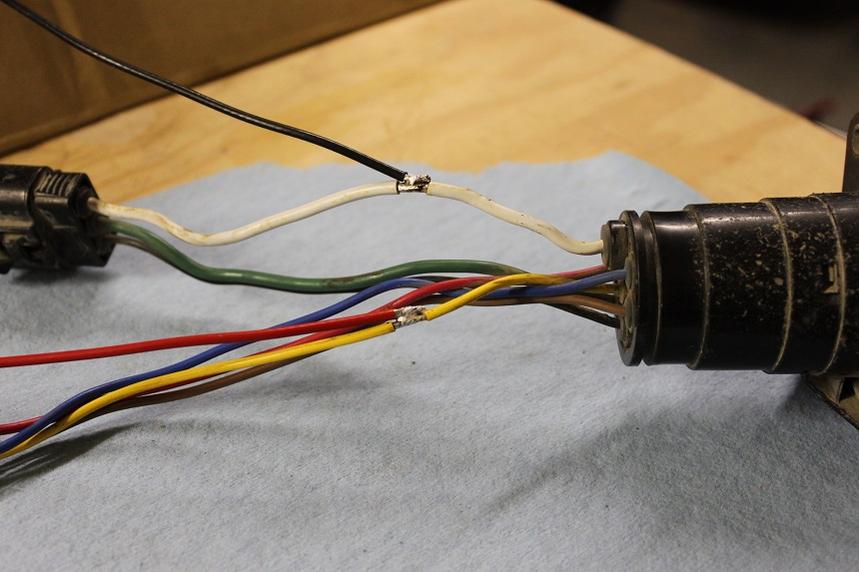

Spliced mine into the tow harness. White is negative, Yellow for positive...in the harness.

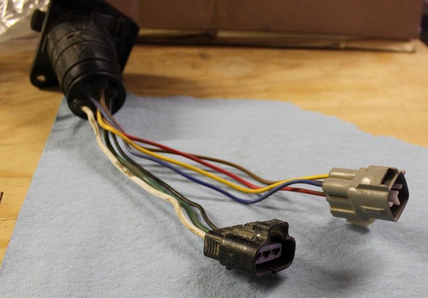

If you spliced it pre plug harness...use a 12v circuit tester or back track the wire from the bottom picture, from the plugs.
