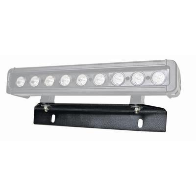

I traded cars with my Son for a few months end of last year. Hated the loss of light backing up.

My friend has a cheap $20 led ditch light as a reverse light on his GX and it’s really bright for a backup light, a license plate frame mounted led bar could help quite a bit. It would require some knowledge on circuits though if you wanted it to fire automatically when you shift into reverse. Or just have a shop install it.
