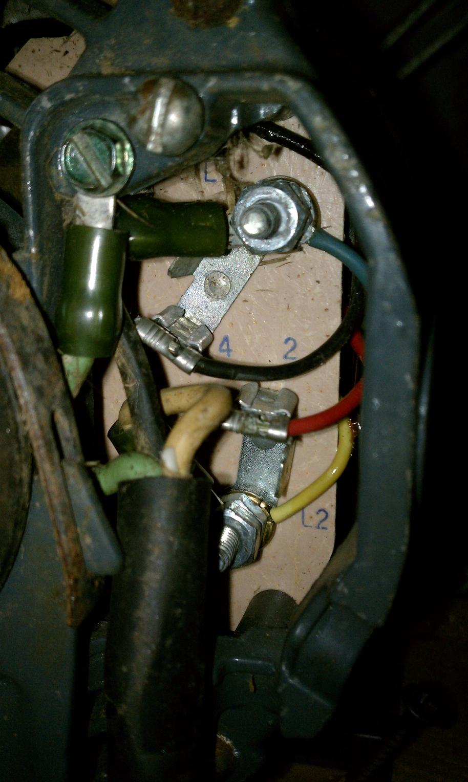

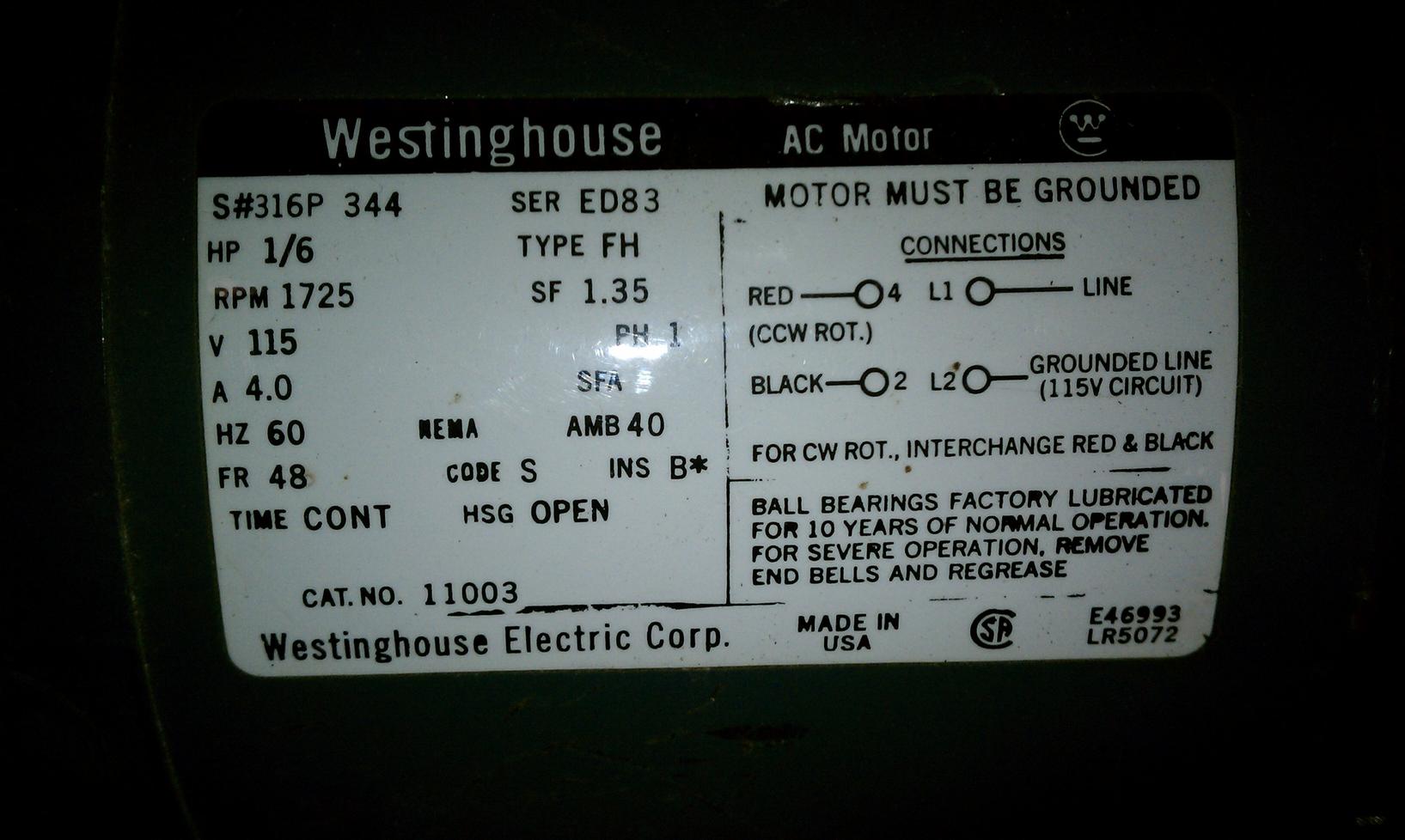

I have a Westinghouse 1/6 HP motor, the fan blows air backwards. This motor is reversible. I assumed switching polarity would work (switching the two leads at the 3 prong end). Motor still spun backwards. Opened the back plate and switched the red and black wires (like it said on the info sheet). Motor hummed and did not move at all. I cut the power immediately. Put the red and black wire back where it was. Motor still hums and will not move. God..... did I frell it up? :redbrick: :bash:
Can someone tell me what to do? Explain to me like I'm 5 years old... I've searched online so much but I can't seem to find that eureka moment...

I think the capacitor is burnt. but it is strange since it seems it can get up to full speed. If a capacitor was burnt, it wouldn't be able to provide the "second" phase to drive the rotor?
In this case, the motor starts slowly, gets up to full speed, surpasses what I think is operating speed, then I guess the centrifugal switch cuts it off, and it repeats speeding up and cutting out.
Can one burn a capacitor when switching the leads if you fail to discharge it first?
