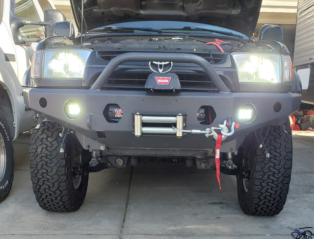

Finally got it 90% install this weekend. Did it all myself. The rear was a piece of cake but the front was a huge PITA. My bros were going to help but I couldn't wait and just went ahead and got it done.
Last things to do are wire everything up. Just waiting for my waterproof connectors (for license plate, fog lights, & turn lights) and some wire to come in. I also need to relocate the winch control box.
