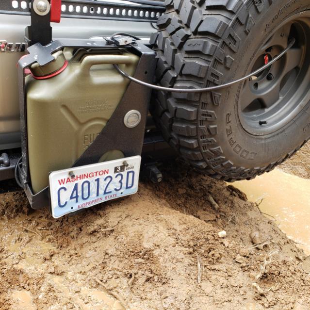

I don't live in a great neighborhood. I call it Warzone Kent, WA. I have padlocks on the Jerry can holder as well as running a thick cable lock through my spare around arm body, and jerry can itself.
Once I get my RMR roof rack, i think i might start putting my Hi-Lift on the rack and maybe move the jerry can as well. I keep dragging the license plate on transitions that have steep departure angles. This would also decrease the amount of weight beyond the rear axle.

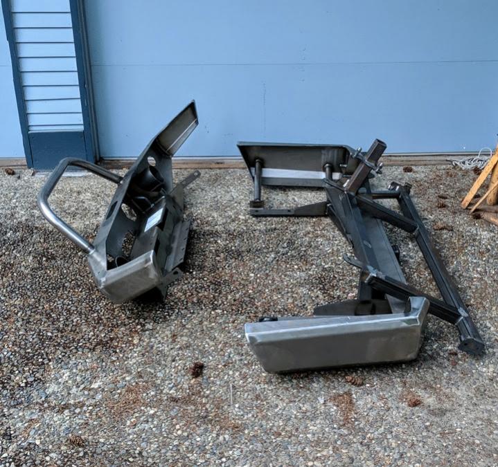

going to the powder coater today...

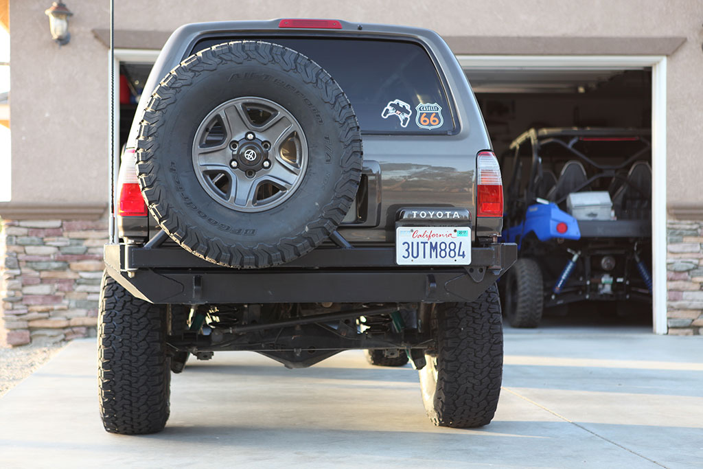

Also.. For those of you thinking about throwing on some big 35" tires...
Side note. As far as fitting large tires with this bumper. The 315/75/16 fits just fine on the rear swing out.
But,
During suspension articulation a 315/75/16 (or 35") tire will contact the rear bumper at the outboard leading edge of the wing on the wheel well side. *hope that makes sense* It's not too extreme, but it does contact.
I just got some longer bumpstops, 4.5" Daystar Comp bumpstops to see if that keeps me out of the top of the wheel wells with my 3.5" backspace SCS F5s. I am trying to keep from having to hack the rear wheel wells up that much. They will be replacing my Daystars that came with my SS 1.2 rear only lift.
