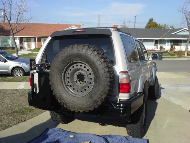

Sorry fella's I've been out of town all day with the family and haven't be online. I logged about 250 miles of pavement pounding today in the 4Runner and I'm happy to say I have t noise, vibrations, rattles or really anything from the tire carrier. If it wasn't for seeing the top 1/3 of my spare when looking in the rear view I'd never know it's back there.

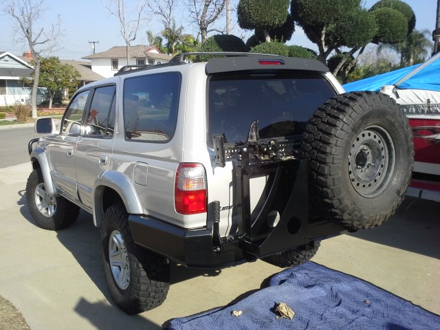

I will say that the handle/latch design thingy (highly technical term) is a little quirky. It's hard to tell in the pics but it's a two part system. The big handle pivots on a bolt attached to the swing arm and locks into place when vertical. Then there is a spring pin that clicks in one of two pre-drilled holes in the handle as a safety to keep if from accidentally releasing. Once it's closed and the spring pin in it holds like a tank but the release pin tends to get stuck and takes bit of force to pull it loose.
I do think that mine in particular is tight due to excess paint in the pre-drilled holes from the body shop.
On the other end of the swing arm is another spring pin that rides on a nice stainless steel skid pad that will lock the carrier open in 2 different positions.
I'll try to snap more pics of the latch system.

Looks great. Exactly what I was looking for. Would love to see some side shots so we can view how far out the tire goes. I hang a dirt bike off th back and need the clearance.
Here's a decent pic of how far the tire hangs off the back. Tire size is 265/75 on OEM 5 Star wheel. The actual tire carrier gate is snugged up very close to the tail gate, within an 1" or less. Very nice, snug fit.

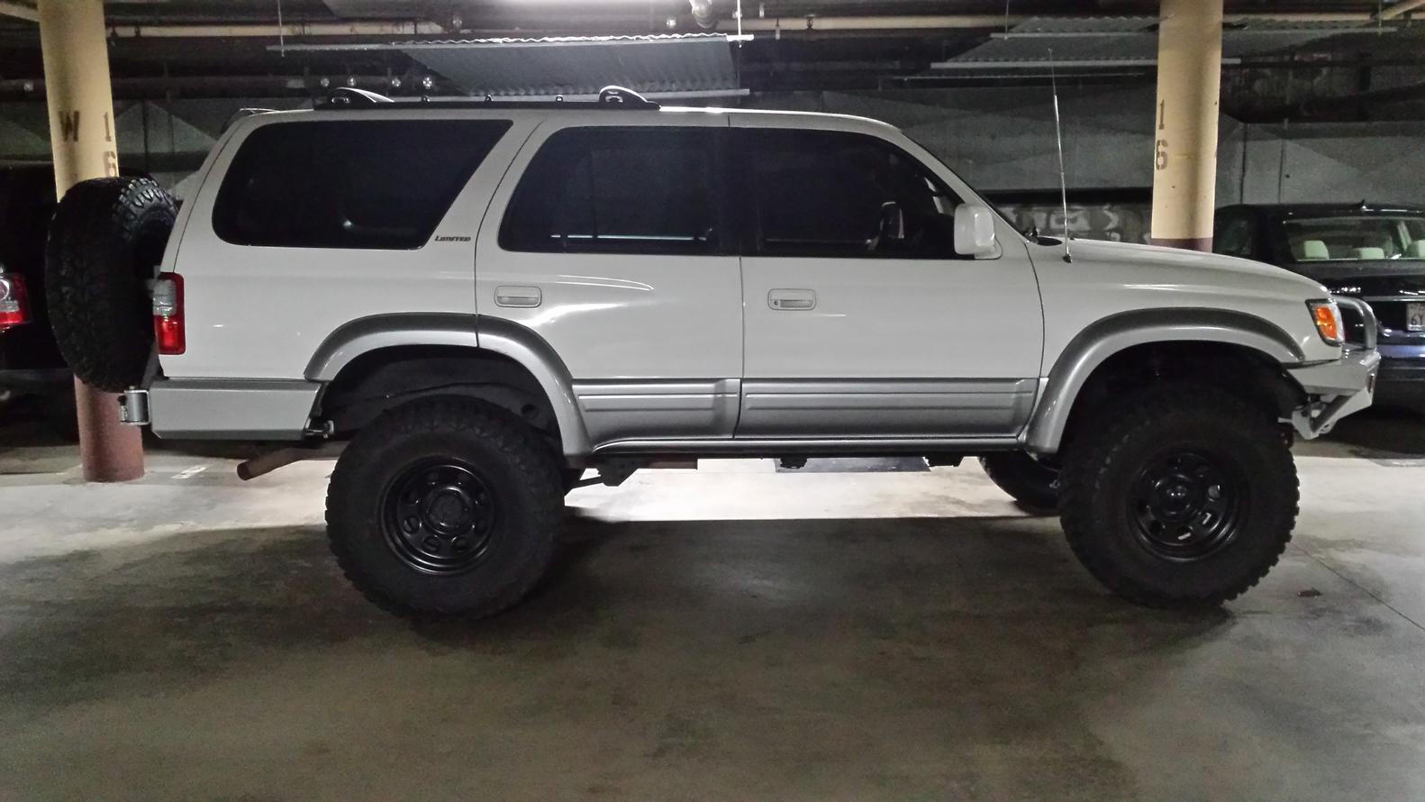

Love your rig! :rockon: I posted on your thread several weeks ago when you first put the bumper on. What tire size and suspension set up do you have?
Yes i remember your post. I have the Sonoran Steel 1.2 lift with OME 861s in the rear. The 1.2 rear coils were not tall enough for all my gear and rear bumper so i sold them and got the 861s cause i like the rake. Tires are 285/75/16 Hankook Dynapro MTs.:thumb:
The bumper is set back from the flares to accommodate 35's without cutting.

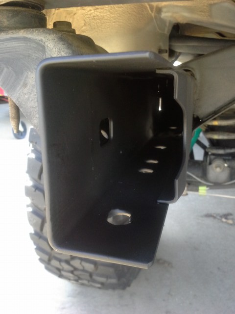

[MENTION=79813]E-LOK'D[/MENTION] and [MENTION=114619]cbr900boy[/MENTION]. Installation of the rear bumper - How did you guys take off that welded 2 hole bracket inside the frame rails? I think I'm going to sawzall and hammer chisel it out. I saw on the other thread torching it out might be a little to much.
I never touched thoses brackets. As a matter of fact you still use them to mount the bumper. What i did with the 4x innovations bracket is i pushed it forward passed the factory welded ones. You just have to line up the holes and you're in business. So in total i used 8 bolts even though you have the option to use 10. Hope this makes sense.
Actually I left those 2 welded nuts in place on both sides and just used re-used the 4 17mm bolts that were there from the factory. I cut the nut strip in half and slid the back two in with a magnet on each side. I drilled the extra holes on the very end of the frame rails so I have 5 bolts on each side. :bigok:
Thanks [MENTION=79813]E-LOK'D[/MENTION] and [MENTION=114619]cbr900boy[/MENTION]. I took the sawzall and the hammer to the brackets. Took about an hour to remove and prep/paint. Will install the bumper today with the whole nut strip.
