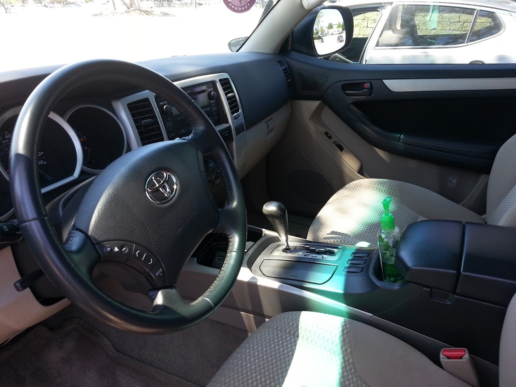

Thanks! Here is a pic of the car (picking it up on Saturday I hope) https://lh3.googleusercontent.com/-...AAAAGA8/9xIDO2dZ0RY/s1037/20130420_122532.jpg. Looks to be black.
Looks like I might need to find another part then?

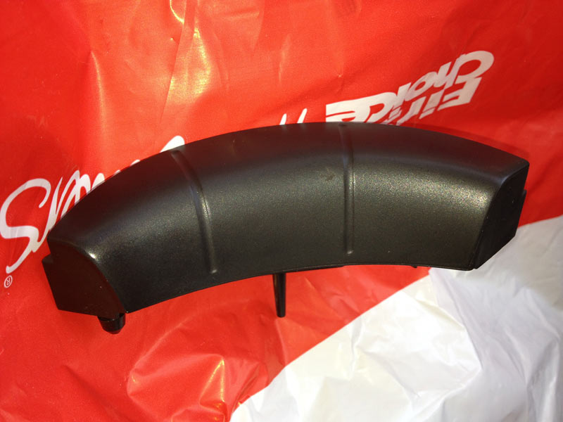

I was reading somewhere that 84244-35030-B0 was the black color buttons. Did you order black or grey? Trying to find out which buttons are black. The original install post #1 they look black to me.

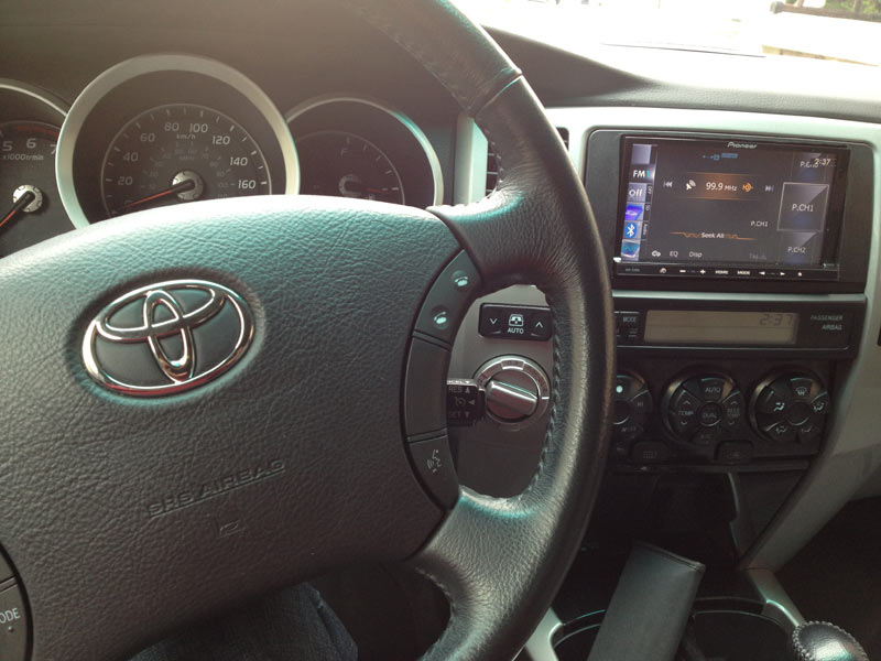

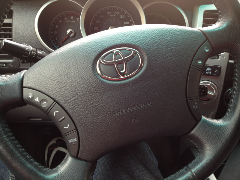

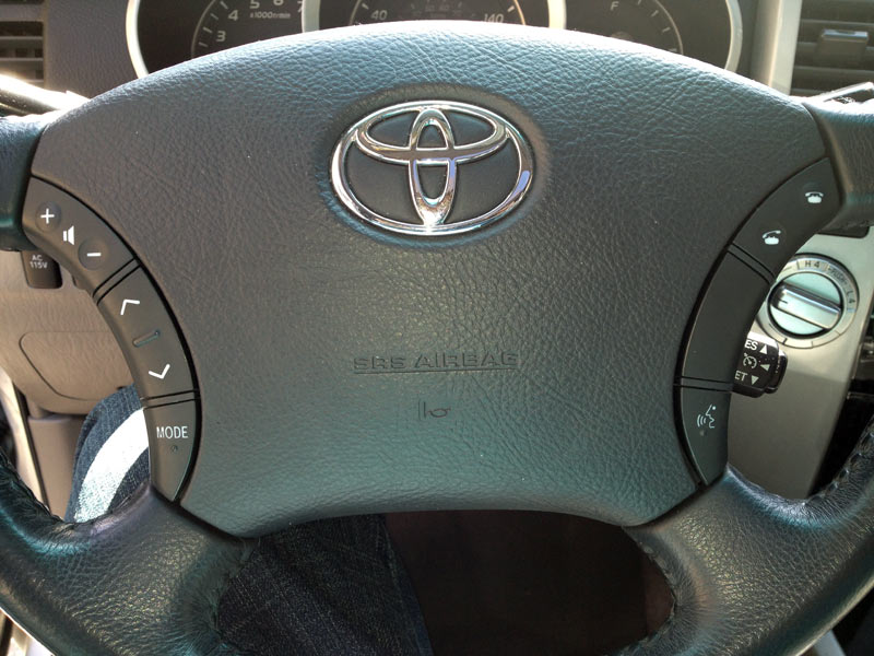

Mine is Grey. See the pictures
Hey Buddy!
I did the research for you. I asked the dealership about the color.
They told me that the last two alphabets are color codes.
So 'B0' color code is for the Grey and the Dark Charcoal is 'B1'
Your part number should read
'84244-35030-B1'
Let me know once you get it. I have posted pics of my truck too. Have a look.
Cheers!

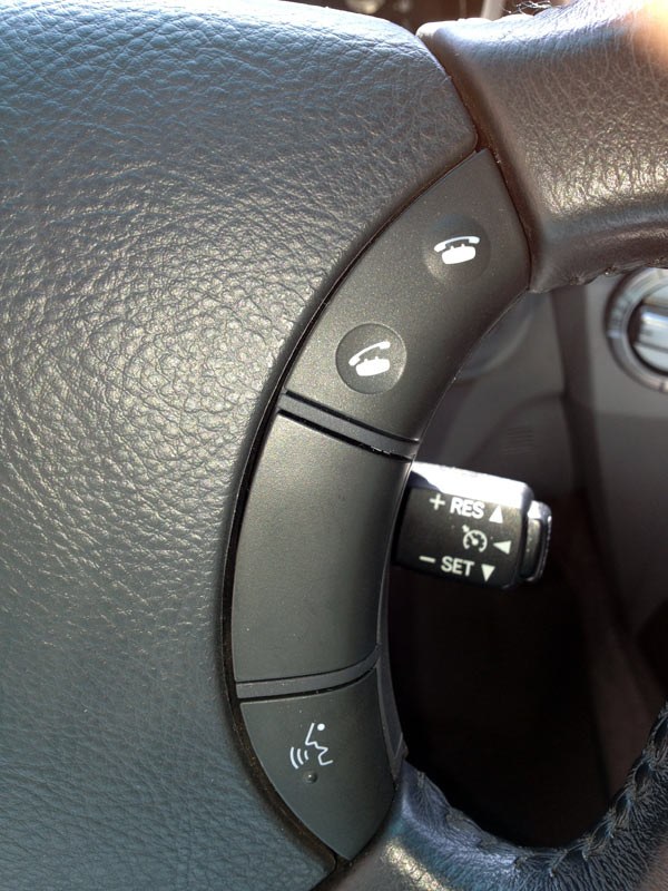

You know what! I was looking at this B0 of my truck, it is quite dark in color. May be it can match your steering. Or go to the dealership and try and see if they can advise you something, then you can buy it from any other place.
Can you send me a close up picture of left hand control in sunlight?
Here's some close up pics of the switches. I think it B0 will work for you too.
Good luck Buddy!

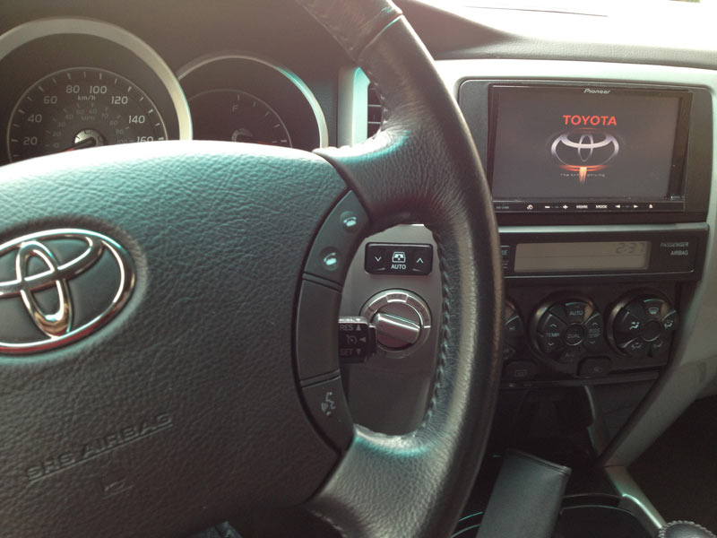

I got my part in today. Had tons of work and my final grad school presentation for this semester (nailed it!) so I didnt get to work until 10pm. Got it installed properly. Thanks for the write up and all the help everyone!
