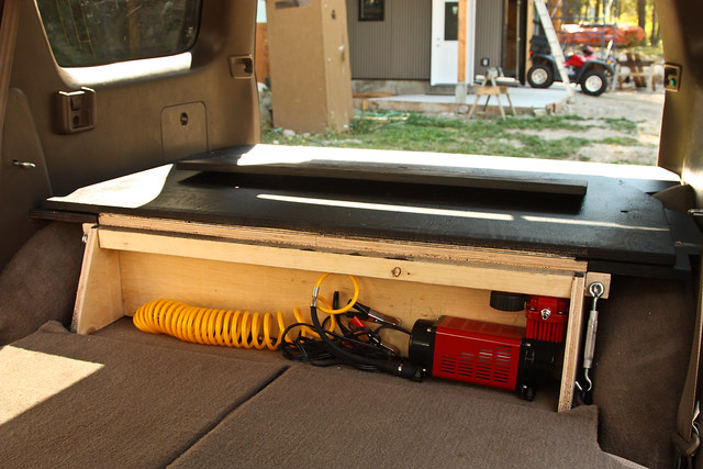

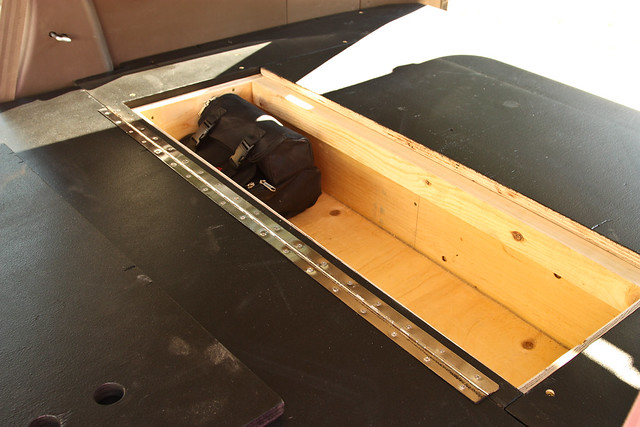

View of the small storage area behind the seats when they are folded up. (I know, I know, I forgot to mask off the under area when bedliner was applied....) The pump will be hard-wired when I get some time.
IMG_0209 by RickaShay24, on Flickr
Storage cubby measured out to hold my two Thermarest Luxury mattress's.
IMG_0211 by RickaShay24, on Flickr

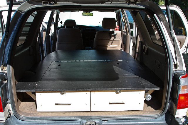

Folded flat.
IMG_0213 by RickaShay24, on Flickr
another angle (sorry, overexposed!)
IMG_0216 by RickaShay24, on Flickr

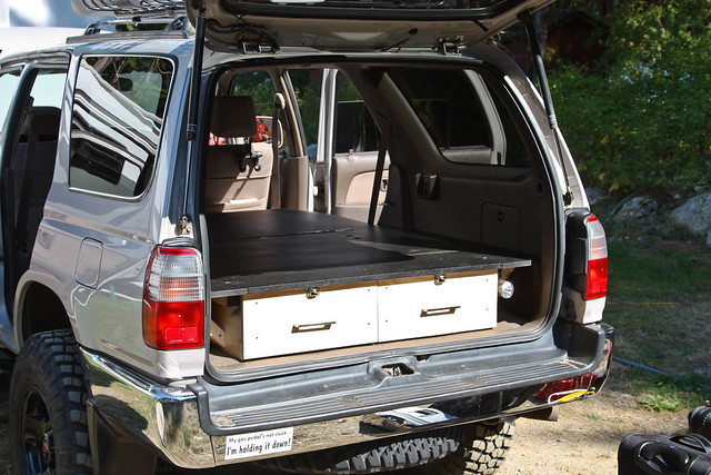

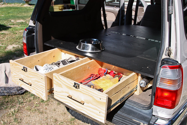

Drawers open (rated at 75lbs.)
IMG_0220 by RickaShay24, on Flickr

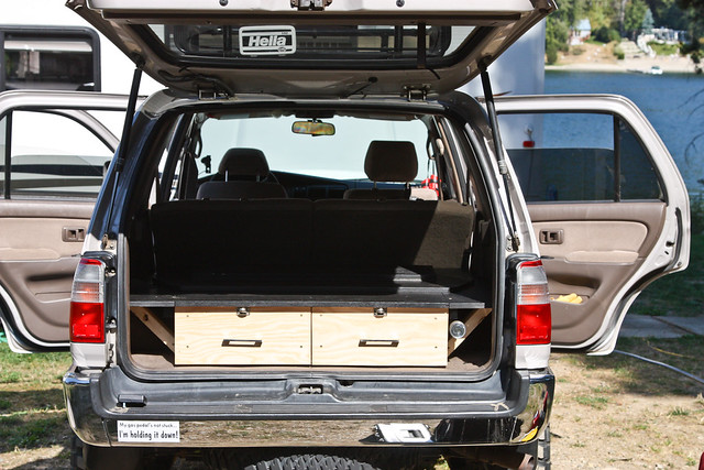

Folded up, with seat backs up.
IMG_0223 by RickaShay24, on Flickr
Very nice! What'd that run you if you don't mind me asking? Weight? I like the fact that you used actual drawers instead of storage bins. It seems much more thought out.
Nice.
It will make the wheeling/camping trips so much easier.
On mine, one drawer holds my wheeling tools and stuff. The other is most of my camping/cooking/survival stuff.
My food and clothes get tossed in the front seats for the night.
I remember seeing Victor's version of the sleeping platform very much similar to yours.
I like this idea of more storage space with the sliding drawer design...really makes for a clean look. Good job man!
Nice work. I like your idea with using the piano hinge.
Platforms are one of those things that are not considered to be "one size fits all". Everyone has different wants/desires/needs with them.
For example, I didnt want drawers underneath, because I wanted to keep my surfboards underneath the platform for DD'ing. Also didn't want it to be heavy. I actually made mine with a single peice of 4x8 5/8" plywood so it stayed light.

I think I am in this one for around $140 if memory serves....
I wanted to keep it as light as possible but there is a lot of framework on the underside. If I would do it again I would use 5/8" for the tops and 3/4" for the base or supports. I used 3/4" all around. As for weight, I am not sure, probably 60-70lbs.
Yeah, Victors was what really got me thinking. I didnt really actually look at his design but I just saw that he had one and how nice it was to have storage under his bed.... I was sold.

I made the same type of cubby. I carry my spare CV in it.
Yup, going to be doing that too!

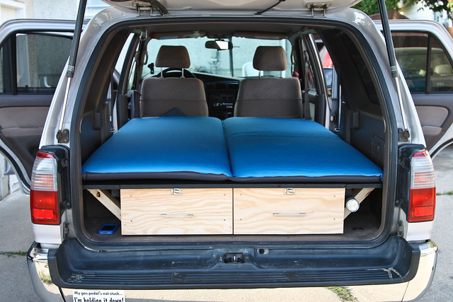

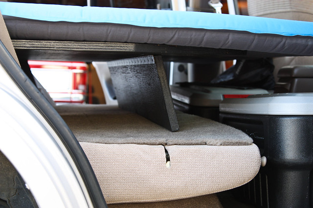

A couple more shots today after i did some test fitting!
20110912-IMG_0231 by RickaShay24, on Flickr
The Thermarests fit perfect!
20110912-IMG_0228 by RickaShay24, on Flickr
nice, very nice! i love it! curious; what size thermarests are they? i have two xtra wide, extra long 3.5s i use, would be great if i didnt have to buy any new, smaller ones! lol! and you never know, i get extra lazy when i have money, lol!
good to know. i have the xtra large, so looks like they wont fit in there :/

The platform is tied down to the factory floor mounted D-Rings behind the rear seats.
